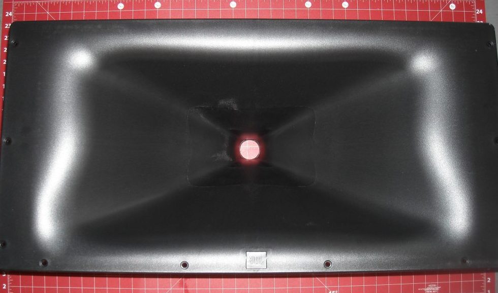

Having only heard this horn
https://josephcrowe.com/products/3d-cad-files-horn-no-1994-es450-biradial-for-jbl-2446-2-throat
https://josephcrowe.com/blogs/news/es-450-biradial-no-2143
in a system with the B&C DCM50 midrange and a Fostex T96A tweeter in this waveguide
https://josephcrowe.com/blogs/news/lens-no-1896-for-fostex-t96a?_pos=2&_sid=8054c5b96&_ss=r
, I’m troubled trying to decide between that horn and the JMLC AH425, which some at diyaudio.com have argued I should have Troy Crowe build for me instead, if partially because I happen to own a pair of those undrilled horns, though my budget is large as I’ve been saving for years.
Presumably, the narrowing directivity patterns of both horns are similar.
https://cdn.shopify.com/s/files/1/0...ot_2023-10-14_170306_480x480.png?v=1697317415
But might the ES-450’s vertical response likely be wider than the AH425 below 1kHz though narrower at 10kHz?
And while having a mere ~ 4 ft sweet spot, would the 425 horn offer superior imaging and vertical spaciousness?
With a wider sweet spot would not the ES450 deliver horizontal spaciousness?
What other sonic differences might you expect between these horns?
How to decide??

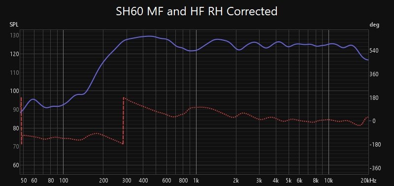

MF and HF together
Note how the phase 'falls in' nicely.

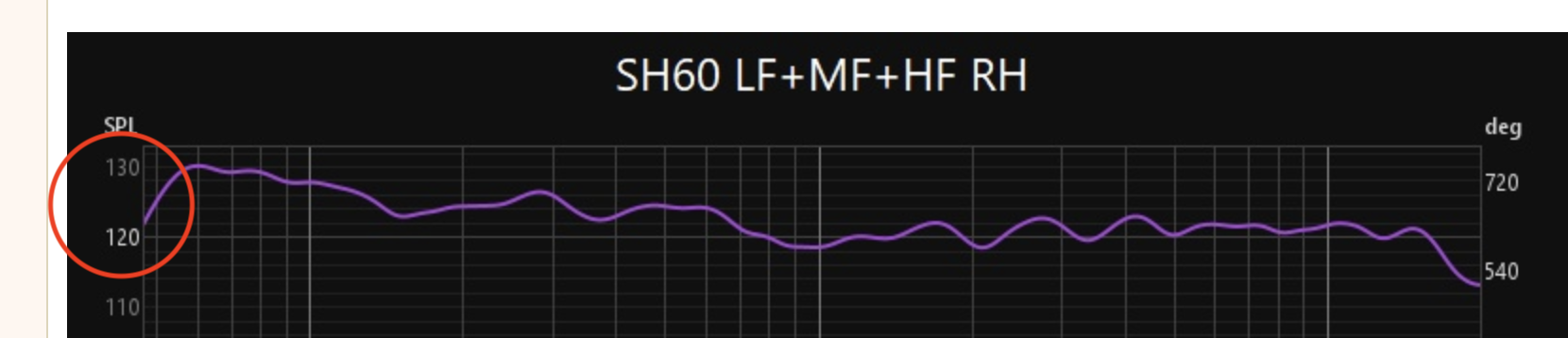

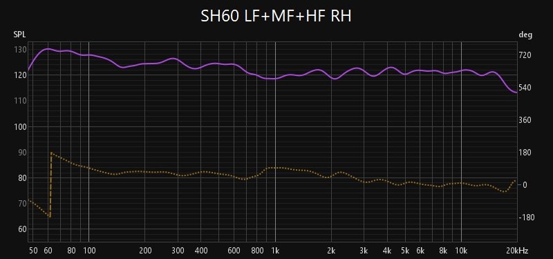

LF + MF + HF
Overall phase just came together without any time alignment changes needed.
Pleased with these.
