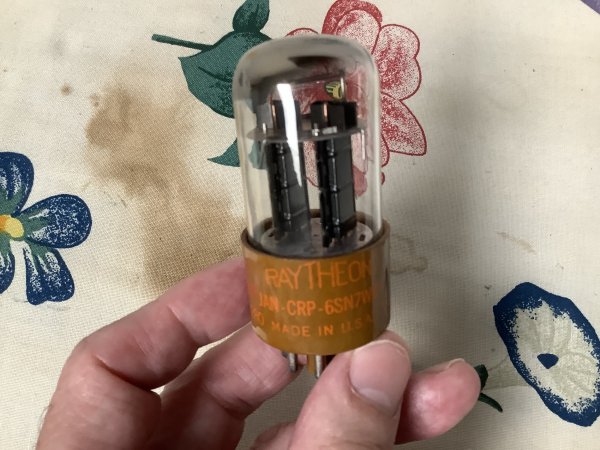

Another great under the radar 6SN7 is the brown base Raytheon 6SN7WGT with the top getter and “umbrella spokes” coming down from the top mica. Very similar sounding to the W, it is a fairly rare find these days. I prefer it to either of the Raytheon VT-231s.

The 6SN7Ws sound like the brown base WGTs with the dryness much reduced and in its place a slight midrange bloom. Great tubes! I find all the Sylvania top getter tubes (even the GTAs which are a pretty nice tube for a reasonable price) to sound more linear and neutral than the bottom getter versions like the VT-231 and the badboy, the bottom getter ones sound sweeter and more euphoric.
I'll research the Raytheon 6SN7WGT in the usual places.
