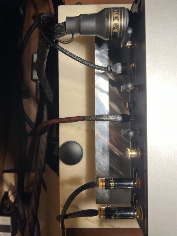

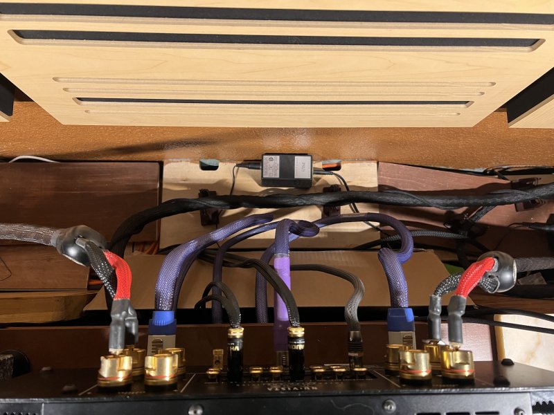

My first post and not the best pics, so bear with me. I find that having the right length and little slack makes for a tidy look. Plus my power cords pass through the inside of my cabinet, then come back out the bottom close to the dedicated outlets. This keeps them neat, and away from interconnects and speaker cables.
Nice
