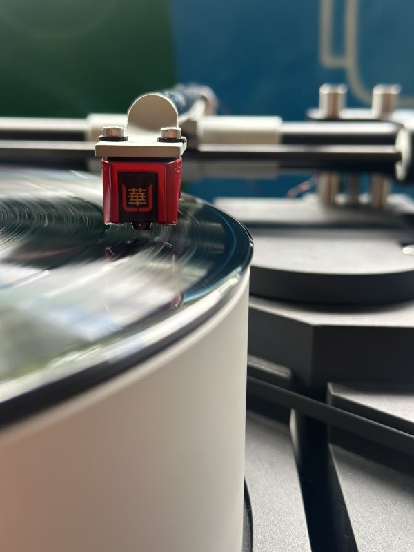

So, while playing around recently with the Hana Umami Red, I felt uncomfortable with the tonearm being in direct contact with the cartridge; I decided to try a little tweak from a UK company that claims this will enhance the sound. So, I installed it, did the usual checks and sat back. Yes, it changed the sound; the percussive attack was reduced, and the sound stage had become more narrow. It had made the overall sound of the cartridge less lively. I played around with VTA, but this wasn't a VTA issue, and I had adjusted the arm with the additional height.
I'm just curious about people's thoughts on isolating the cartridge from the tonearm and if anyone has had any better results.
Turntable is the Bergmann Galder with the Thor tonearm

The cartridge and tonearm should funnel resonances away from the delicate stylus/cantilever mechanism. Isolating the cartridge would trap resonances and lead to the sort of sonic results you described.
Why?
It is a clear indication of ruining the sound of your cartridge and turntable. It also means that it is very effective absorbing details, dynamics and reducing your cartridge's value to 1/4.
All tweak manufacturers claim the same but only a few really does enhance the sound. The rest simply alter the sound and almost always in a bad way. IMHO there are two completely unnecessary decoupling tweaks (besides many); the rubber or spring types under speakers and in-between cartridge and tonearm.
Main concern was the was some dulling of the lacquer where the cartridge and tonearm were in contact. The lacquer is soft and easily damaged. Something I can live with but there is a possibility of the two surfaces reacting over time.
Yes it was a useful lesson.
A cartridge is a consumable product which has app. 500 hrs stylus lifetime. Keeping this in mind there shouldn't be a concern of scratching lacquer finish on the cartridge but on the other hand I understand your desire to keep it in pristine condition. I wouldn't care lacquer finish when SQ is at stake but that's just me.

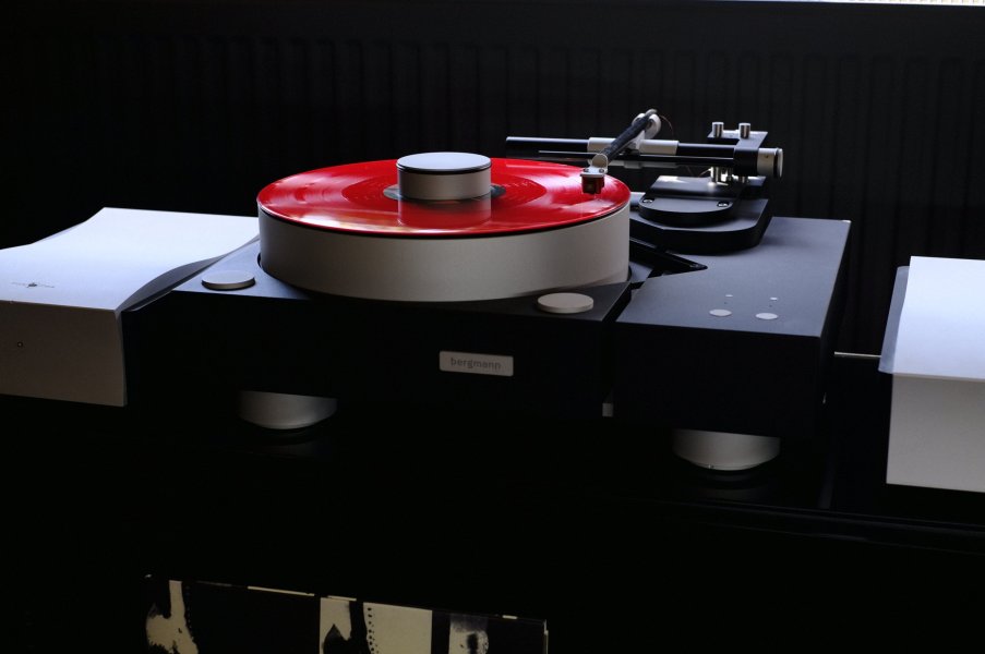

It sounds as though it is managing to absorb some of those unwanted vibrations and yet still hold the cartridge in the optimal position. I did not try the device on my arm but did try the Origin Live Optimizer, which was not beneficial. That was as far as I got. I was listening to Lee Morgan—Side Winder last night after our conversation, and I must say I am really impressed with the Bergmann / Hana combination.
