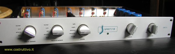

On the front panel the controls are from left to right;
Input Select: Tuner/CD/Phono/Aux/Tape
Record Select: Tuner/CD/Off/Phono/Aux
Mode: Left/Right/Stereo/Reverse/Mute
Output: which is the Volume Control
Balance: Output to left and right channels.
All these controls are of high quality and have that solid yet silky feel to them in keeping with the status of Spectral and their products.

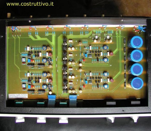

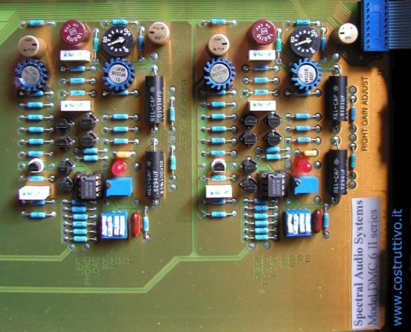

The all important on board phono section, which is the high light of this preamp is well thought out and a joy to use and hear.
With the preamp facing you and top cover removed.
On the left hand side is the phono stages with dip switches
marked 800/100/30/10. setting the desired dip sw to (on)
loads the stage.They are not addative so select only one.
If 47K for MM is desired than select none(all off).
Now three inches to the right of said dip sw is the gain
potentiometer 0-100. use a small screwdriver to set the
gain in relation to the main volume control. Remember there are two dip switches and two gain control pots, one for each channel, so be sure to set both of them.Mine sets at 800 ohm load and 50% gain for Denon DL 301 MKII.

Thank you so much for this! This is such a rare preamp, I can never find anything about it on the Inet, except for what I wrote. LOL I have had the term Spectral, and Threshold in my Google alerts for a few days, and this thread jumped up.
I am also a very happy owner of a DMC-6. (Series two, I think it says Delta inside - That is not mine in my avatar) About 12 years ago, I paid $1,350 for mine, and was told it went for $2,850 list. When I first heard the phono section, I was absolutely SHOCKED. It is almost as quiet as the high-level, (But I'm using it with HO MC cart) I went to the KAB site, used their recommended gain chart, balanced it to within 1/50th of a dB with LMS, (you can magnify the graphs on the monitor to do that) and I can not believe how stunning it sounds.
I read somewhere that with this preamp, they do something different: They put some section of it ahead of another section. I just can't remember what it was, but it increases the S/N ratio of the phono. It's a very fine looking piece, and it looks like the same knobs as the Threshold Fet-9 and 10. As for price, I have been tracking this and Threshold stuff for a few years. I saw one go for as low as $650, when I started to do so. I saw one a few months ago, go for closer to $800. I think the thing holding the price down is that people don't really know what it is, and even with their new gear, Spectral doesn't advertise much. I don't think they are interested in market share. LOL
If this picture upload works, the pic here is someone else's DMC-6.
I'll start another thread, or p.m. you about a couple things. I didn't want to curtail this thread. Suffice it to say, if one pays about $700 for this......it's like robbing a bank!
Dave - Thanks for the kind words on the review and for posting these additional pics, which I have added to my file and future knowledge of the DMC 6. For analog mavens such as myself
