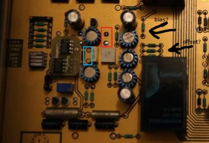

How to bias the DMC-10 Delta
Hello Demain, and thank you for designing such wonderful products !
I don't know if you monitor this board, but I have a DMC-10 Delta preamp that I inherited from my father (the original owner), and it has not been used in a few years. I opened it up and all looked fine inside (capacitors looked intact, no signs of any stress internally), so I fired it up and it sounded wonderful driving both a solid state amp and a tube amp. However, I do not want to use the DMC-10 for any extended period without checking the bias and offset values. I have the manual that came with the unit, and the desired offset and bias values are given there, but there is no clue as to where on the circuit board to place the multimeter probes to check these settings. It's clear that there are four sections, and each has two adjustment pots (a flat white pot with a large screw adjustment, and a smaller vertical blue pot with a tiny screw adjustment). However, it's not clear where to measure the bias and offset values on each stage.
Thank you in advance for any help you can offer on adjusting and caring for this superlative piece of equipment !
Its been years since I looked at one. The basics are as follows:
The bias current is set via a resistor to the positive rail in series with the output FETs. If you are looking at the board with the controls toward you the component layout is very similar to the schematic. The resistors are 100 Ohm resistors that are vertically oriented on the right end of each section. You measure the voltage drop across them. The larger square pot in the center is the bias adjustment. Its easy to goo too far so be vareful. +/-20% makes no real difference inthe setting. The offset trimmer is the small vertical trimmer. its a 20 turn pot. In the center right of each section to the right of the three output fets there are three resistor that sum the currents. At the center on any of the resistor leads where they tie together. is the point where you set the bias.
If you need send me a photo and i'll mark it up with the test points.
Demain, thank you so much for your help ! Here is a picture of the board. I see the pots you are talking about. I have attached a "raw" picture of the board for you to mark up, and also a close-up with what I think are the correct resistors marked with an arrow. (Ignore the little red and blue boxes ... that was just an initial guess I had made earlier prior to contacting you.)
To the right of each bank of three output fets I see five resistors. The center one is attached to a visible circuit board trace in the two right-hand sections, but not in the two left-side sections. My guess is that the three center resistors in each bank of five are the summing resistors you are referring to. Would I just measure the offset by checking the voltage between the ground plane (presumably the surface of the circuit board, or the chassis) and the center resistor lead that's facing the fets (or should I work on the far side of those resistors, facing away from the fets ?)
Last question: Am I better-off doing these measurements with shorting plugs in the appropriate inputs as I check each section ? (and presumably the left-hand two sections are the phono stage and the right-hand two are the line stage.)
Thanks so much once again ! If you're ever in Tucson and you want a fantastic Sonoran or Oaxacan mexican feast, shoot me an email and it's my treat !!
(Ignore the little red and blue boxes ... I think it's the ones with the arrows marked)
Thanks again !
