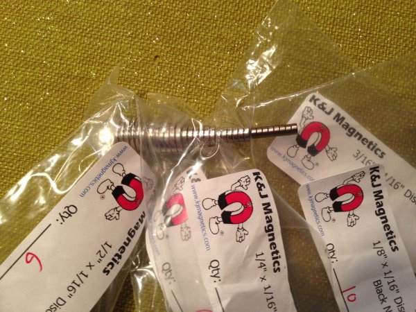

I used two 3mmx1.5mm (3/16" x 1/16") Neodymium N52 magnets in the arm and five layers of mu-metal tape that I use throughout for shielding, about 0.5mm total thickness. Any thicker and one of the sides would win and the arm would tilt permanently. Mu-metal is ever so slightly magnetic, unlike metallic rings that I also tried, and perfect for this application. The magnets are temporarily attached with blu-tack.

And a whole bunch of magnet sizes I had in hand to try:

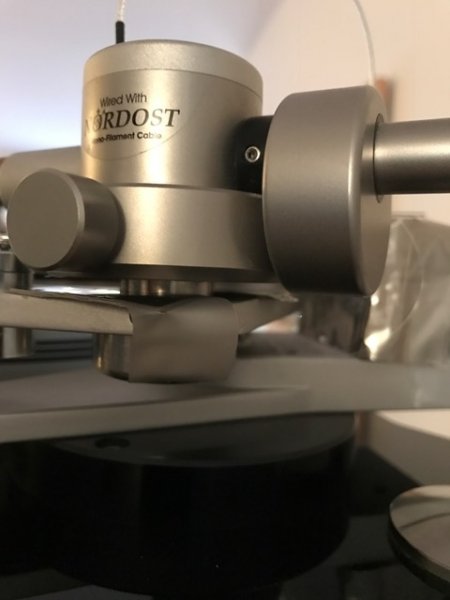

The bad news is that the ring magnets CANNOT easily be used, because the arm's stabilizing "ears" hanging off the sides (as shown below) are magnetic (some sort of steel, unlike the rest of the arm which is aluminum) and they interfere with the rings - basically, they are strongly attracted to the ring magnets and overpower any repulsive action of the small magnets under the arm. So to use these ring magnets one has to rip out those "ears", which I don't want to do (they are not screwed in, from what I can tell). I should have tested those "ears" for magnetic behavior before ordering the ring magnets.

Well, if at first you don't succeed, try try again... I spec'ed out more ring magnets, this time with a smaller outer diameter plus much tighter inner for a snugly fit, thinking that they would not interfere with the "ears", and it turned out to be true; the arm is now fully stabilized using repulsive forces. The use of a high precision caliper helped a lot in this effort.
Specs: 3mmx1.5mm (3/16" x 1/16") N52 Neodymium round magnets in the arm, and two 20.7mm ID, 31mm OD, 0.8mm thick N35 Neodymium ring magnets

One of the additional benefits of using repulsive forces is how quickly VTF stabilizes on the gauge, something that is not true with the original arm. The obvious benefit is that the arm is extremely stable, much more than using attractive forces. The downside is that azimuth adjustment (by rotating the counterweight) is now more difficult, if you don't have a "perfectly" engineered cartridge like the A90 - one would need severe counterweight rotation to get even a small amount of adjustment; I did not have to adjust azimuth at all.
