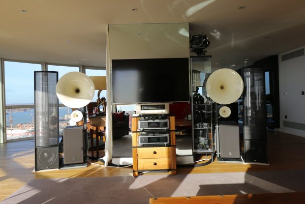

Interesting stuff and may explain my disappointment with newly purchased Martin Logan 13A speakers.
I'd been using Avantgarde Uno horns for many years (recently changed for Duos), but decided it was time for a change. I bought a pair of Quad 2905s and was impressed with their sound (surprisingly similar to the Unos) but "barn doors" are not acceptable in my listening room. After a dealer showroom demo I bought the 13A speakers as I was convinced they'd be a big improvement over the old Unos
Let me describe the room. It's almost semi-circular with lots of floor-to-ceiling glass and about 975 sq ft in area but only 7'7" high. There's a central column and the speakers are placed either side of this and facing across the room. There's about 12 ft behind one speaker and 15 ft behind the other but the glazed wall behind the speakers is at an angle, so no direct reflections. Same with the wall behind the listening position.
The horns sound great, but the electrostatics just don't sing. The Room Correction kit (Anthem PBK from ML) makes little improvement. However when listening from behind the speakers (in my dining and kitchen areas) the MLs sound far better than the AGs, though this was expected.
I'm sure that these new MLs should sound better than the 14 year old Unos, but they just don't - by a significant margin. So the MLs are for sale and I've acquired a nice pair of used Duos recently. I'm sure that my room is a bigger problem for the MLs than the AGs. Would you agree that this is the likely cause for my disappointment in these highly rated and reviewed electrostatic speakers?
Thanks. Peter
PS - AGs powered by NAD M32, Accuphase A-36 or Cyber 845 monos - MLs powered by Sanders Magtech or GamuT D200 III

I have used and enjoyed Martin-Logan Monoliths and Monolith IIIs and then Prodigys since the 1990s.
I think your room makes it very difficult for planar dipole speakers to work. I personally would never attempt to place panel speakers in a room in which:
1) each speaker has a different distance to the front wall, or
2) the front wall is curved, or
3) the front wall is uncovered glass.
Hi Ron. Well, before committing I had first asked on other forums (ML's own, AA, etc and ML themselves by email) about the suitability of 13As in my room and most suggested it would be a positive advantage to have the big distances to the back (you probably say front) wall. Perhaps the last place to ask would be the ML forum as users tend to have a bias towards ML speakers, but no one put me off. Furthermore I had found that Quads offered exceptionally good sound in the same location, so I had no worries with the MLs. Sadly a different story when installed.
I sold my 14 year old Unos for exactly the same price I had paid for them new (nil depreciation) and found a good pair of slightly newer Duos at a truly bargain price, so the big loss on the MLs will be mitigated to a large degree. They are still for sale - UK spec. Peter
I am very glad this story has a happy ending!
Totally agree with Ron on this based on four different ML models over 25 years.

Hi Ron. Well, before committing I had first asked on other forums (ML's own, AA, etc and ML themselves by email) about the suitability of 13As in my room and most suggested it would be a positive advantage to have the big distances to the back (you probably say front) wall. Perhaps the last place to ask would be the ML forum as users tend to have a bias towards ML speakers.
Dear Peter,
I am sorry so many people led you astray. All you needed to do was to ask us.
bonzo75
Feb 26, 2014
22,628
13,653
2,710
London
Another Peter led astray. :oops:
Peter, I am at the same post code you were at when you lived in London.
Extract of my message to you on the Martin Logan forum back in 2017. This is when I was still more favorable to apogee and suggested that for ultimate speaker not only planars,
"For your particular room, I would go horns, because you can place them back towards the glass, in any position as long as they have space, and the wall behind them has no effect. I would then add a curtain to pull over the glass for critical listening. "
Anyway, I am sorry to disappoint you, while you have gone horns, you have chosen the wrong one. As you remember back then I was suggesting trios (though much higher budget).
You could get better horns at much cheaper price for your room, but it comes at the cost of being led astray a few more times on forums.
Thank you for providing so much information.
That's a LOT of asymmetry between what the left and right speakers are seeing, which could be an issue. Horns are the least affected by room asymmetry simply because of their constrained radiation patterns.
Here is another thought that comes to mind: Good integration between the panel and woofer in a hybrid electrostat can be largely a function of room acoustics and listening distance. You see, the panel approximates a line source, where the SPL falls off by 3 dB for every doubling of distance. In contrast the woofer is effectively a point source, with the SPL falling off by 6 dB for every doubling of distance. These effects are real; I measured them on SoundLab Dynastats (hybrids like your Martin Logans) when I had a pair years ago. The net effect can be a mis-match of several decibels between the loudness of the woofer and the loudness of the panel at the listening position.
