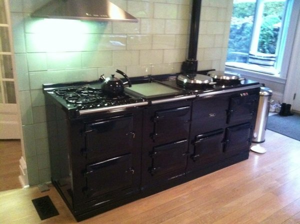

Thanks Keith, perhaps we'll give that a go on the Aga. I usually do steak on the outdoor grill, but the Aga is wonderful for roasts; i'll need to check with my wife on what the temps are in the various ovens on it. It is the size of a small locomotive.

what's an "Aga"
I'll send you a pic. It's an old cast iron stove with a glazed ceramic surface, famously referred to in old english novels, it stays on all the time, no dials or controls, warms the entire floor where located. you control cooking by moving the food from one oven to another, each is at a different proximity to the gas heating source. they are essentially assembled in situ, and weigh a ton. make a wolfe or stainless steel stove look tinny. They are still made.
I saw one of these being built once on tv in the owner's kitchen. The cast iron pieces are massive, and space between iron plates are filled with sand. There is no unfilled dead space in it. They really do weight almost a ton, depending on the size aga you get. The one in the photo is a big one.
