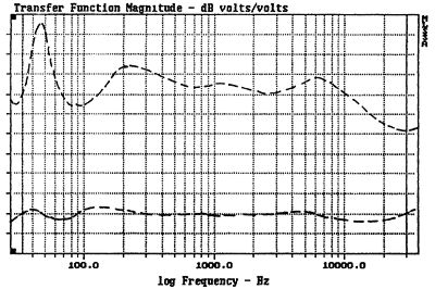

That is not what makes the audibly different. Impedance can be high or low. What makes a SET amp an equalizer is the *variations* in impedance, not its nominal marketing number. Here is the author himself again:
"The output impedance of these amplifiers is in the ohms range, hundreds of times worse
than solid-state push-pull amplifiers. This requires careful mating with loudspeakers that
do not have great impedance variation with frequency. "
So what I am saying is 100% the same as what he is saying. I welcome you to find speakers with flat line impedance curve.

(...) The most credible and obvious reason SET amps can sound different is what I highlighted in blue from his text: that their output impedance is high and hence interacts with that of the speaker far more than solid state does. In that regard the SET amp comes with an equalizer built-in that differs with the speaker used. That variation is readily audible, and provable with both psychoacoustics and subjective listening tests.
People (Martin Colloms was one of them) have taken a high damping solid state amplifier and connected a power resistor in series with the loudspeaker having the same value of the output impedance of the SET amplifier with it. It was reported that it does not sound like a SET at all. I also tried it and can confirm it (although not in DBT), so you should take it just as my opinion.
