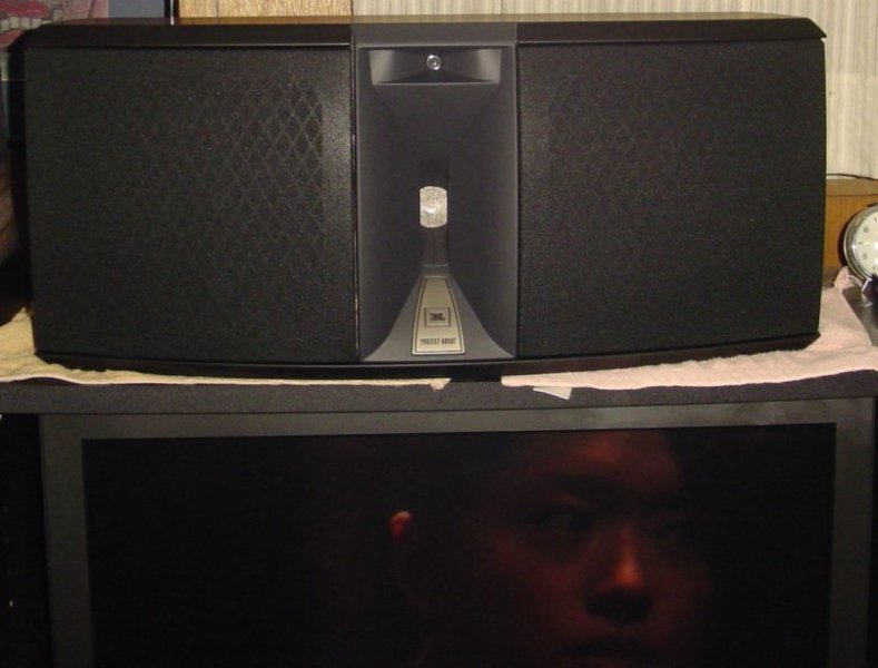

The link you provided shows a center using the same components and layout as the L/R speakers. Why not ask Troy to just build you a center like that? That would be my first choice. It basically centers the MTM array in the cabinet using the same drivers, and perhaps rotates the horn (waveguide), for horizontal placement.
IME, center matching is not super critical since you are focused on the video, but having a large discrepancy (mismatch) between sides and centers can be distracting (at least it was for me). My Maggies sounded better with a Maggie center, for example, though the conventional speakers I had in place before getting them set up worked OK for me with several different (conventional) centers. I ended up getting a Magnepan center after living with a conventional center and Magnepan L/R speakers for a while. My current (conventional) system uses the center speaker recommended to go with my L/R speakers. My gut says you would be better served having a horn-based center given you have horns in the L/R mains. With few exceptions, horns tend to sound different to me than conventional cone or planar systems. I feel I'm in good company; Paul Klipsch designed the Heresy as a center between Klipschorns back when he was pushing for three-channel playback systems instead of stereo.
