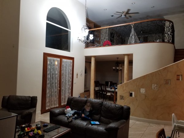

i will take photos of the room later today
maybe you will see some issues there

I definetively think its the room here you also have those cavities to other rooms without doors open staircase etc.
Not an easy space.
To get a topsound you need to get a custom designed listening room
Not a gearchange
And if thats not possible i would drag in bigger speakers possibly the big focals or wilson X2 EA MM3 .MM7
My own designs off course
But it still would be tricky.
