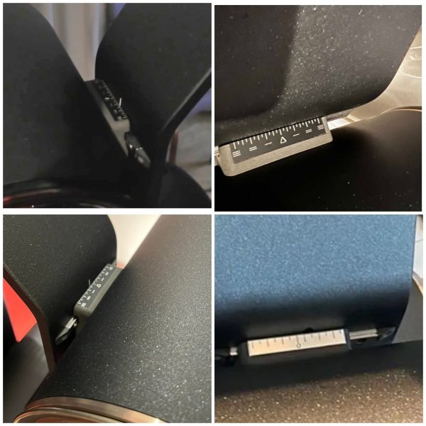

I was surprised when I saw that you brought the tweeters forward after toe-in unlike the other setups of trio g3 which have tweeters moved back after toe-in!
You said that when the speaker is toed-in, the tweeter moves away from you and should come forward, But what has been said and seems reasonable is that when the new trios are toed-in and the tweeters is point directly at ears, then the tweeter must be moved back to make the alignment correct again, because with toe-in, distance of that offset tweeter is closer to the ear than other drivers.
At Axpona last year(first pic from the left) and also other setups, when trio was fully toed-in and the audience was sitting too close, the tweeters were pushed back for achieving physical alignment again to prevent any harshness.
Thanks for posting the pics. I took several photos of the trios at Axpona and at Angie's but never took a pic of the tweeter scale.
Thansk to @Germanboxers for posting a pic of the relevant manual page. I applaud AG for putting these things in the manual with diagrams but I think it is still a little more confusing than it should be. Perhaps it is the translation to English. But, the 5th paragraph down on the right hand side of the page states "The tweeter needs to be moved forward when toeing-in and backwards when toeing-out". This makes sense to me.
There are two parts that aren't clear. One is where to measure on the tweeter horn (top, bottom, inner edge or outer edge). Jerome showed me but I just can't remember. I was origianlly using the bottom as it was close to the top of the big horn. I used the laser distance meter and took several measurements using the bottom of the tweeter horn and several measurements using the top of the tweeter horn. I came up with an average of 6mm difference between the two. So it definitley matters which one is correct. I have sent an e-mail off to the distributor to get clarification on this.
The other point that is not so clear is what is meant by toe-in and toe-out. In the manual it shows that the line of the big horns is pointed at the listeners ear. (Perhaps this is the zero point on the scale.) So, If I rotate the speaker to point the tweeter at my ear I am technically toeing-out the speaker. This seems counter to what they are talking about with regards to imaging focus since pointing the tweeter at the ear tightens up the focus. I don't know. But once I get the spot on the tweeter horn that I am supposted to measure distance it doesn't really matter as I just shoot for the magic 48.5cm.
To me there is one correct position for the tweeter. I don't trust where they put the tweeter at a show to serve as a guide. I don't think there is one person that likes listening to a bright speaker. And they want people to like what they hear. So they can adjust the tweeter position and use it like a "tone control" of sorts. Push the tweeter back and the upper end gets dull and muted. This is exactly what I heard at both demos.
Yes, without a doubt, the meaning of toe-in mentioned in the manual is when tweeter starts pointing from the outer edge of the ear to the inside of the ear, and toe-out is when tweeter starts pointing from the outer edge of the ear to the outside, so when the tweeter points right inside the ear, it has a greater distance from the ear and it should come forward to reach that 48.5 cm, but in shows like Axpona or the Avantgarde room itself and some other Showrooms that I posted pics of the tweeter scales, for these setup situations where there are more listeners, The main goal is a wider image and not more focus, because the coverage of the listeners is more important, so in fact the Trios are toed-out(from pointing at ears), and in this mode, the tweeters are closer to the ears and have to move back.
