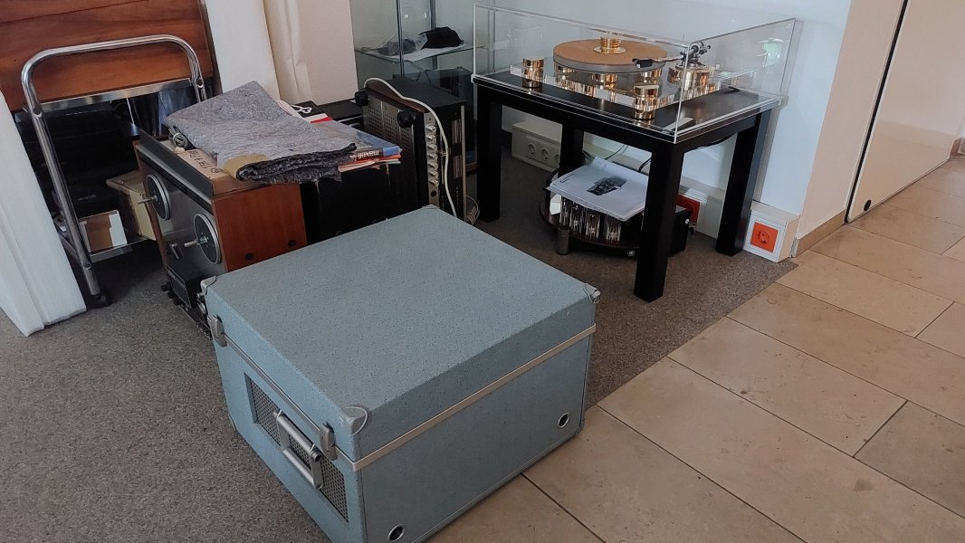

I was in the tapewalhalla today in germany .
Eternal arts audio , picked up my new NOS B 62, it has the original studer case its not the model in the picture.
Bought the tapestage and dropped of the other B 62 and M 15 A for repair check up

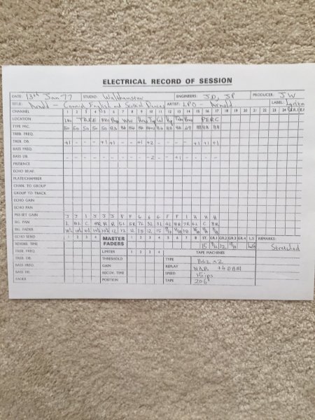

Here is the electrical session sheet for one of the most famous and sought after audiophile recordings, The Arnold Dances on Lyrita, engineered (as all Lyrita stereo recordings were by Decca). John Dunkeley, the recording engineer gave me a copy of the session sheets to include in my FIM Decca book back in 2013. Notice he used two Studer B62's for the recording, done in 1977. Also used Scotch 206 tape at 15ips 2 track. Arnold himself conducted the London Philharmonic. IMG_4220.JPG

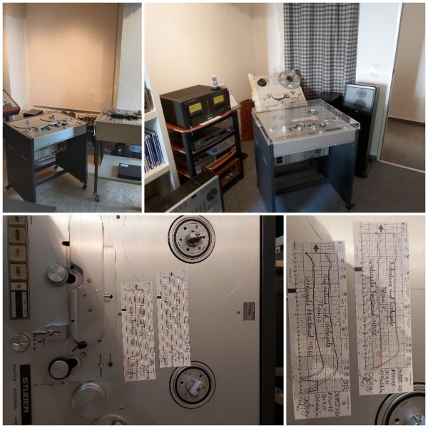

+- 1 db 30 hz - 20 khz ccir calibrated on SM 468 studiotape.
My new B 62 .
The Original box is in very good shape , looks great.
As is the tapemachine itself technically up to date
It s adjusted so it can also play the modern SM 900 tapes .
Here is the electrical session sheet for one of the most famous and sought after audiophile recordings, The Arnold Dances on Lyrita, engineered (as all Lyrita stereo recordings were by Decca). John Dunkeley, the recording engineer gave me a copy of the session sheets to include in my FIM Decca book back in 2013. Notice he used two Studer B62's for the recording, done in 1977. Also used Scotch 206 tape at 15ips 2 track. Arnold himself conducted the London Philharmonic. View attachment 62177
Larry
Larry, so you re telling me that one of the most famous high quality recordings of all time was ¨ simply ¨ done with 2 mikes on a 2 track stereo recorder??
I assume the second Studer B 62 was only for back up recording .

Here is the studio plan of the recording. The famous Decca tree is in the middle with two outriggers and a very few spot mikes. Everything is fed into a custom Decca mixer and mixed in real time at the recording to two channels of the B62. No after recording mixing like most everyone else did. Part of the magic of the Decca sound. John was a protege of Kenneth "Wilkie" Wilkinson and worked with Wilkie from John's start at Decca in the late '60's until Wilkie's retirement in 1980. Wilkie did many of the earlier Lyrita recordings. John was assistant engineer to Wilkie after he joined Decca and then John became a full engineer, doing many of the later Lyrita recordings (as well as many other Decca, L'Oiseau Lyre, etc. recordings). He told me that even after becoming a full engineer, he would often go as assistant engineer on some of Wilkie's recordings.

I had nothing to do at work , so i post some more pics and do something usefull :).
Below also a good picture of the FR response.
This machine did the most ¨ important ¨ on location recordings , the A 80 being to heavy was ¨ just¨ for the studio :cool:

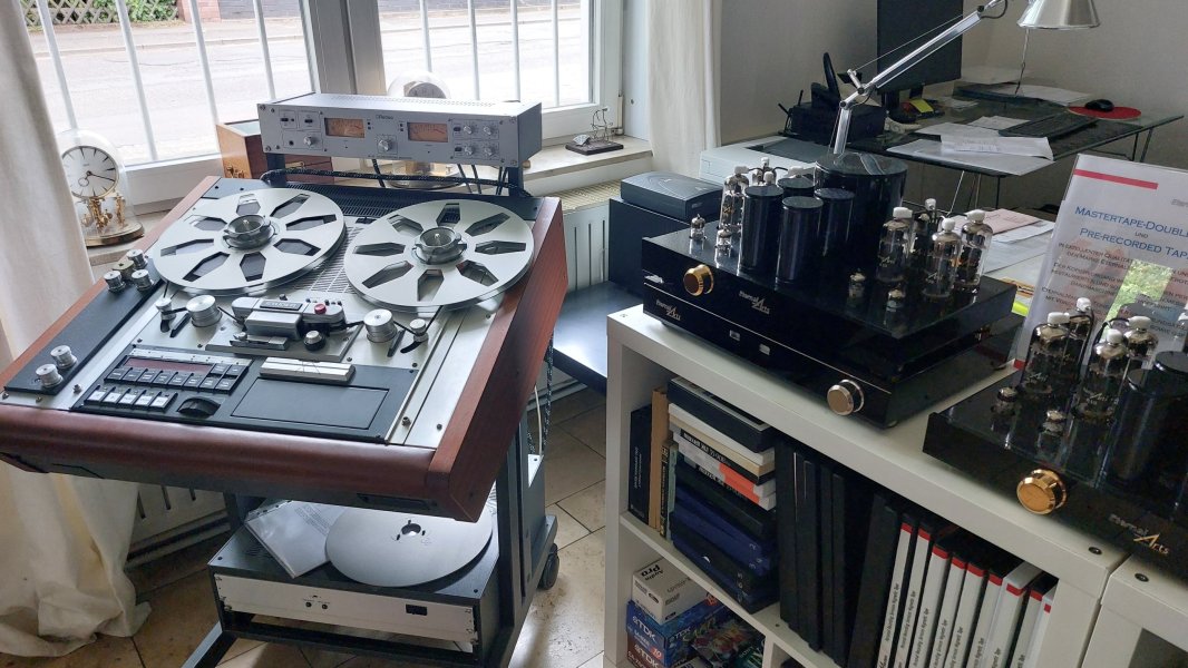

Not sure if the Tube tape pre is a stayer , on some recordings i like it and some not , i bought it mainly because it is adjustable and it has VU meters for recording.
Plugged the B 62 in directly via the original audiocards and played the Hemiolia / pavarotti mastertape today , :) ..... tape is the real deal.
The B 62 never sounded better before , my other one still had faults in it .
