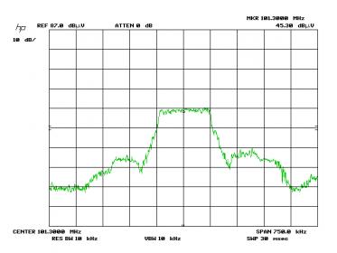

I've attached some spectral plots of IBOC transmissions, to help illustrate what we're discussing here. Each horizontal division is 75Kc wide, two of the blocks make up an analog FM signal width, minus the 'guardband' of 25Kc. As you can see in the first plot, the two lower pedestals at -26dB are the IBOC sidebands in the Ibiquity system now in use here in the northeast.
The second plot shows peak hold spectral mask in green, averaged spectrum in red, and an instantaneous snapshot in blue.
As can be seen, the amount of disturbance wipes out the first adjacent, so say good bye to DX listening.
