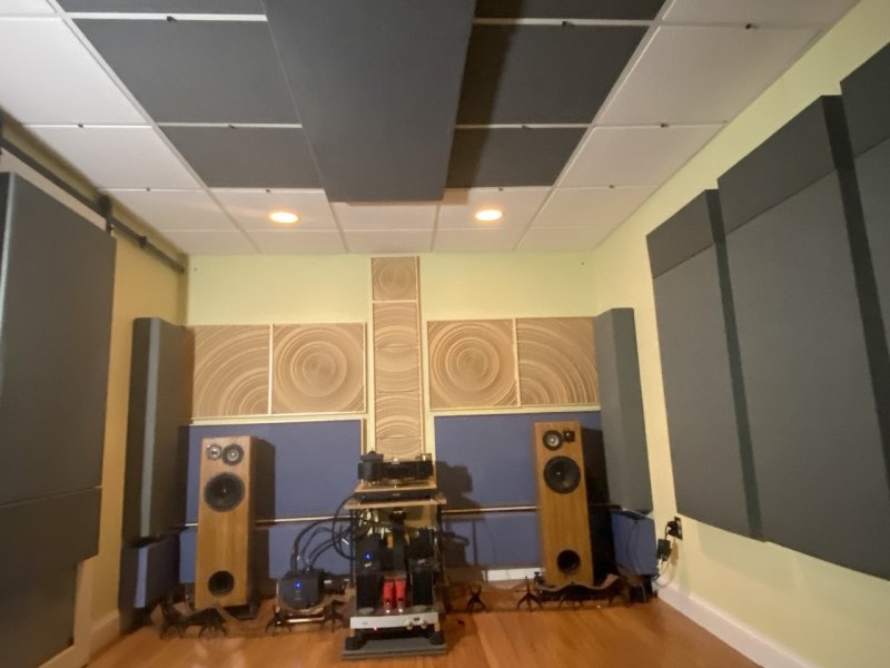

Ron, double dry wall with green glue in between and lots of insulation. There are 2 windows and those could be causing an issue. Thought they were high enough up to be fine, but maybe not. See picture of the room and thanks for the help.C3EEE2BB-4E2B-414C-8462-12AAC3780044.jpeg
Ron, double dry wall with green glue in between and lots of insulation. There are 2 windows and those could be causing an issue. Thought they were high enough up to be fine, but maybe not. See picture of the room and thanks for the help.View attachment 113029
Still moving speakers around a bit, so ignore the towels, I will spike soon.
...it looks like a room that might bounce a bit, but that's natural. For me, I would get a diffusion panel at each first reflection location on the side walls. And listen. Maybe a couple of diffusion panels at the rear. And listen. Modern panels are easy to place and can look good, IMO.
The walls are probably good, and handling the big stuff from what you described; maybe just a little bit of management for the slap/bounce.
If you enjoy the natural light, perhaps go for the windows last, after you see how it goes. They're up pretty high, looks like.
Hard to tell from the lens effect, but is the sofa mid-room? If so, that may be causing a negative impact for you.
Good Luck! Enjoy the process.

Thanks the diffusion panels make a lot of sense. Sofa is about 5.5 feet from the back of the room/wall.

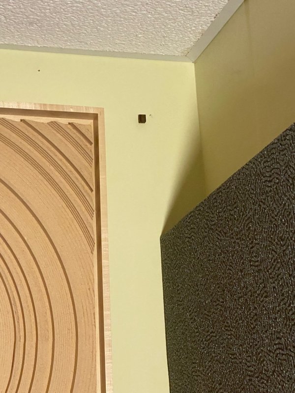

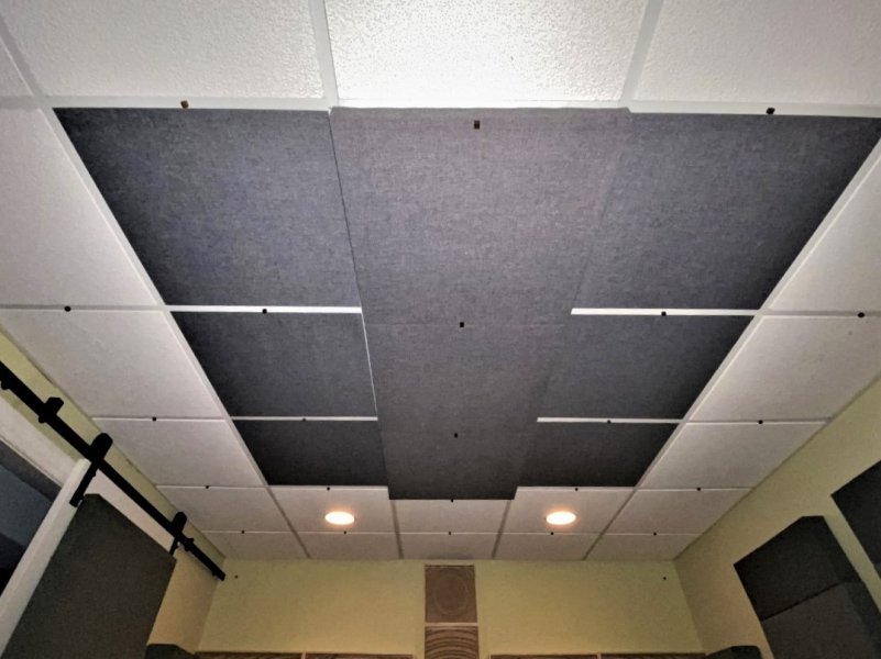

No amount of speaker position tweaking or home furnishings placement can effectively mitigate room acoustical issues in a room with these dimensions. Note that 5.5 feet behind the listening position would typically not be enough distance for diffusion to work well (I've seen acoustic consultants recommend twice that). Your room appears to be too small for diffusion to work optimally, with every surface untreated and therefore reflective. At a minimum you need absorption or combination absorption/scatter panels (or something more exotic-see link below). An inexpensive approach would be GIK panels with scatter plates - 244 panels behind the speakers and between them (below the windows with one edge in the corner) and on the wall behind the listening position, with 242 panels on the side walls. The center panel could be a GIK "Art Panel". The scatter plates prevent over-damping the room. RPG's "BAD" combination panels are superior to GIK but also more expensive. I would also put an ASI "Sugar Cube" in each ceiling corner no matter what else you do, and a couple on the glass of each window. If you use "Sugar Cubes" on the glass surfaces there will be no need to cover them. "Sugar Cubes" also work very well in lieu of panels on the ceiling.
