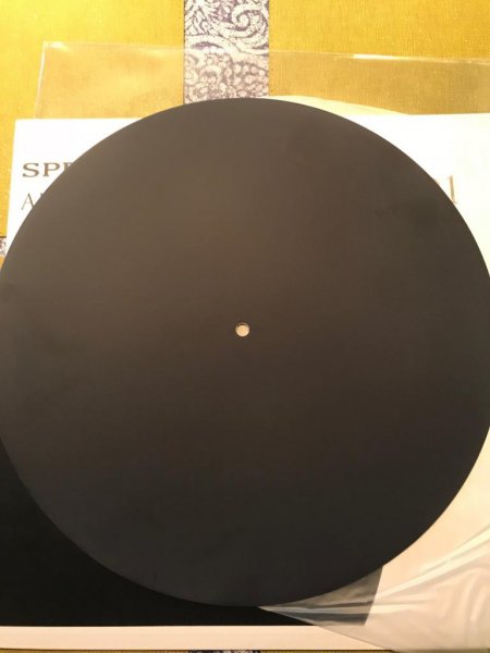

Three layers of Sorbothane/SPEC+ AP-UD1/Isodamp C-1002, ~7mm total, each layer is <2mm thick. The result is transformational, and I have never heard cello in here like this before; bass taughtness and lack of overhang taken to a much higher level; overall, much quieter than before, can tap the LP while playing and hear very little feedback. Added bonus: reduced feedback from the platter and bearing via the spindle/center weight, because the center weight no longer makes contact with the spindle - the thicker part of this spindle is now covered by this new interface, so one may say this spindle is "tapered" and the center weight's hole is now wider than the spindle.
I went through numerous iterations over two months, and this is likely the final interface for this 'table. The Isodamp does not really stick to the SPEC sheet, so an A/B with and without can be easily facilitated. Lesson learned: never buy a turntable with just a platter, a proper interface must be integrated by the manufacturer. This is really a lesson I learned from AJ Conti through the local dealer a while ago.

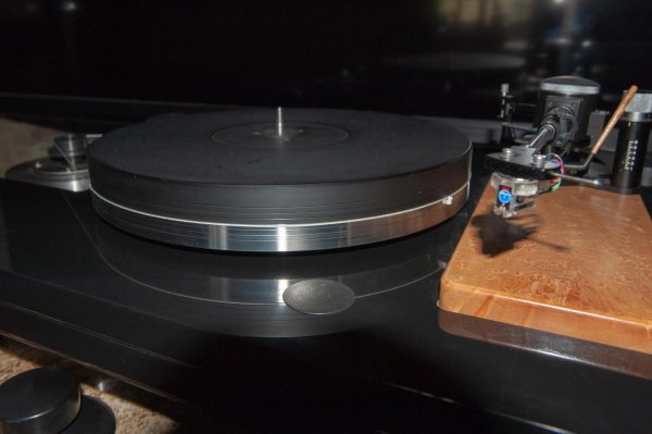

I run a VPI Mk V platter on my TNT. It is probably a couple of decades old by now and is Delrin over stainless steel weighing in at around 20 pounds. I find that in my system, it sounds wonderful and is far and away the best sounding platter I have tried.
The rage at VPI seems to be the all aluminum Classic platter but when I see a lot of discussion on the VPI forum concerning mat materials for it I have to wonder why, so I have not been inclined to move on from the Mk V.
