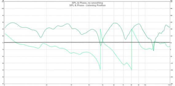

Just for comparison, here a measurement I took this past weekend of a subwoofer. This is the native response with SPL & Phase (No smoothing)
I then left everything the same and moved the microphone to the listening position. You can see that the phase changes due to the room interactions. It said in the legend on the first graph that the phase was 5.7 deg. On the second graph it said 68 deg. (No smoothing)
Finally, I added in the speaker, corrected SPL and Phase with Audiolense, and got this (1/6th octave smoothing):
If he is claiming to have the "ultimate" bass or something, he would need to show some kind of time/phase information to convince me. Just showing SPL doesn't say much about what it sounds like.

Right. For example, a waterfall graph would be useful. Also, if there's a null at 80hz, I know that won't sound like ultimate bass to me. I know that nulls can be be swept under the rug in a simple FR graph. I've done it. The graph will look better but the sound will be weird sounding due to the excessive boost at the null frequency.
I bet he could easily eliminate the null if he had some woofery on walls other than front, depending on which boundary caused the null. Phase shifts at the nulls will look just like what mojave showed before he applied correction in the middle of his second graph post #11.
