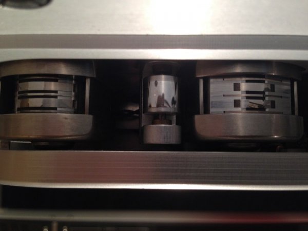

I'm not sure. Perhaps Greg (or Christian) can fill us in. On his site, Greg mentioned testing six different heads from six different manufacturers before selecting the winner. I seem to remember somewhere that the UHA heads are made in Germany. But I might be mistaken.
one of the pictures on the deck features/options page on the UHA site shows a head and you can see JRF on it.
That's it? Current state of the art in tape replay? Precision tape guides, scrape flutter rollers,precision head block? Wow! How can I unsee this?
Too late. Would you like to place an order?

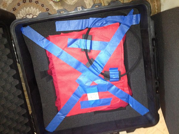

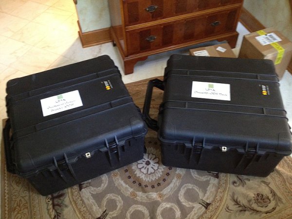

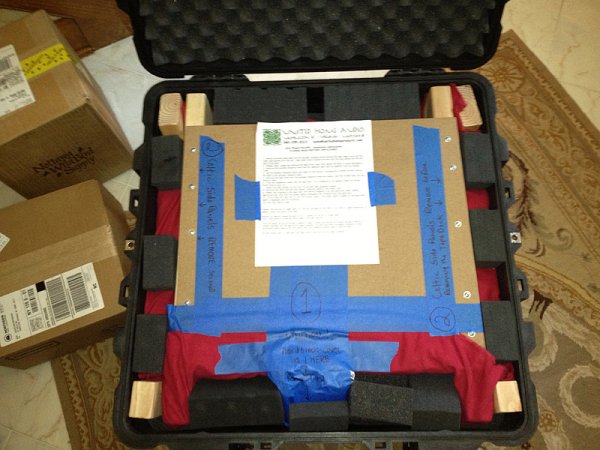

My UHA Phase 11S with Outboard Power supply has arrived. I now have arguably the best analog source playback device available. Quality packaging. I will be setting it up later today.
