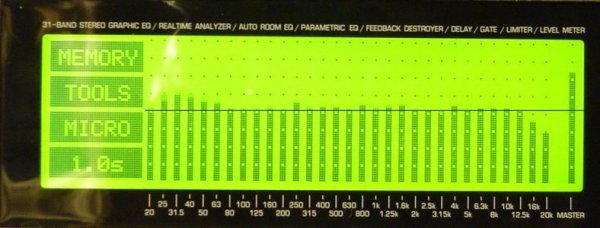

I have used an RTA but not REV. Typical curve elevated below 100Hz or so and a roll-off above about 7-8K. That's an old shot from the listening position with both channels with pink noise.
Rob:)
