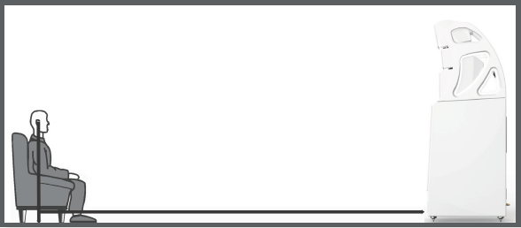

There were problems with the setup that Im sure all who were there would agree.Didn’t Brian Berdan set them up? He’s excellent.
Unless the Wilson ratio has changed wherein distance from tweeter to ear divided by distance from tweeter to tweeter should be from 1.0- 1.25, Patrick's ratio put his sitting position IMO too far back with a ratio of 1.32. Also there was a very obvious shift of the soundstage to the far left. Looking at his right speaker the toe in was greater than that of the left speaker. Suffice to say the sweet spot was far to the left. These are easy fixes which we were going to tackle on our next visit back. I didn't get a chance to verify the upper module settings but will also do that on our next trip back
