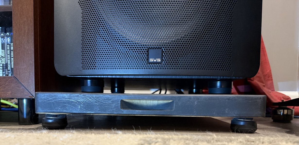

Your subs are coupled to the floor making your floor a passive radiator. If your speakers are on spikes then they too are making the floor a passive radiator. If you like how that sounds, that's great. Ever try isolating your speakers and subs from the floor? You might like it. First rule of Audio: Your system sounds great- until you hear something better.
Many speaker manufacturers sell their speakers with spikes. Seems like then, that is the right way to go. I had my speakers on spikes for decades. Then I tried spring isolation and was blown away by the clarity, sharper imaging and increased resolution. Would never go back. The picture below shows my HT subs on spring isolation platforms. The bass clarity and punch was very much improved by isolating my subs from the floor. The difference- now I could here how the bass was muddied when the subs were sitting directly on the floor- on spikes or the rubber footers it made no difference.
Reactions: tmiddle2
Without some accelerometer readings it is difficult to be too sure.
The subs in the picture will generally have the cone moving in say the Y axis.
And the floor is most springy in the vertical, or Z axis.
With two subs in a cabinet opposing each other, then the forces largely cancel anyhow, so it is unclear whether a whole lot remains going into the floor.
The forces do not cancel. They will be out of phase.
if they are opposed on the apposite cabinet wall, then they cancel.
I found a picture of an example.
And based on your logic, the sub has no sound output.
