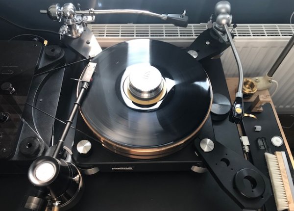

The first cartridge I fitted, was my beloved Koetsu Black Goldline. And as I am interested in the sonic signature of the Rigid Float, I stayed with the Original old and long Koetsu Headshell. (The comparison with the VIV LAB Nelson Hold headshell will be done later)
The Koetsu headshell fits nicely, the arm comes with a simple installation tool and the arm base was moved a little bit and the arm was perfect in position.
The tracking force adjustment is a little bit time consuming, as the oil will take a little time to settle. But as I adjust the tracking force fine-tuning by ear, it doesn't matter too much for me.
For comparison purposes I used a 6N Ortofon Phono wire.
(I have the same cable also in TAC5 and RCA)
The Koetsu Black was before fitted in my FR 64 arms
The first impression was "whow", speed, dynamic, information was on a great level, not yet heard before from the Koetsu black.
The difference is similar like changing from FR64fx to FR64s tonearm.
So you can imagine, that I am very impressed. I start now to understand, why some people said to me, the Rigid Float sound like a good Horn speaker system.
Fast, dynamic, powerful, natural.
I do not know, what the reason is, the Rigid Float stays on a separate steel base aside from the Micro Seiki, the FR arms are fitted to original Micro Seiki gunmetal bases.
May be staying aside enhances the effect of the air bearing of the Micro Seiki turntable?
What ever, the first minutes with the Rigid Float were very impressive. I heard some Jazz with a powerful Sax , and the power was "just there" .
Instead of optimizing the beast, it turns out, that I was just listening to some more records. This is mostly a good start for new component in my gear to stay longer :)
Looking forward to spend some more hours with the Rigid Float, trying different Carts as well, trying the Nelson Hold headshell ....
So some nice hours to come, before Munich is waiting !

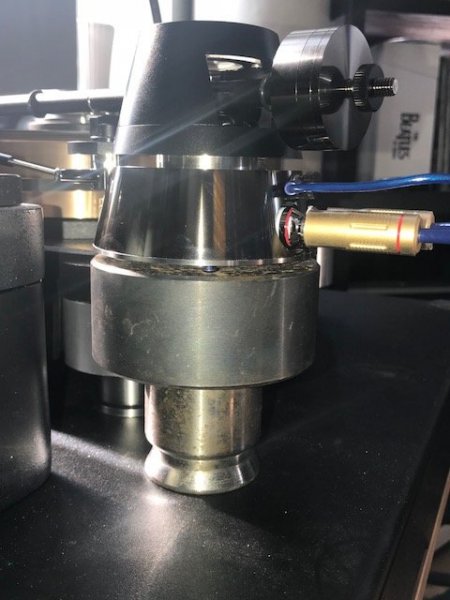

In the times I were a older school boy I choose an internship in a metal craftsman shop. Even in that time, I was interested in improving my turntable, so I created a big and heavy platter weight. Unfortunately it was much too heavy for any turntable, so I stored it for memory ...
On the day the Rigid Float arrived, much earlier than expected, I searched my house for anything I could use for a base, so I tried the J Sikora Platter weight, which was not high enough. Than I remembered, that my schoolboy platter weight might fit. And I found it and it fits in all dimensions. I just had to turn it by 180.
If you know, that it was originally planned to be a platter weight, you will see it.... My room is full of old industrial looking stuff, so the light rusty former platter weight fits nicely :D
It seems, that the young school boy has known, that a 90mm Rigid Float tonearm base is needed some decades later!
As I use the Micro and the Rigid Float on an active Accurion Base, the three rubber feets of the Rigid Float were not my first choice.
The supplied metal spikes are much better. If possible, I try to exchange metal screws on tonearm bases or headshells agains Titan screws, so I changed the supplied metal spikes for M3 Titan screws (standard M3 out of my bicycle customization box) you can see them on one of the pictures , they shine in blue.
I have not done the comparison, but it gives me a better feeling :)
I stopped using the Rigid Float after being in to Micro Seiki and TechDAS AF3P turntables, as the RF arm does not fit.
But since a short time, the German Rigid Float importer constructed a tonearm base for Micro Seiki and TechDAS:
So I might consider the tonearm again, as I liked the dynamic and brute force a lot :)
