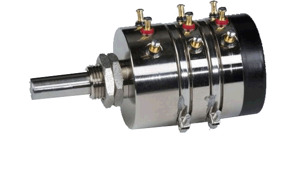

The Spectral Super Fader Technology
To solve the problems of existing gain control systems Spectral engineers have been working with a leading aerospace contractor. Out of this multi-year effort comes an extraordinary ultra-precision gain control. The Spectral ‘Super Fader’ combines mechanical precision, advanced materials science and unrestricted use of exotic materials to create a level control that behaves like an infinite number of theoretically ideal resistors. Inside, the critical moving parts are precision machined from solid precious metals. These wipers have many surfaces that are spring pressured as a group to contact micro-polished optically flat resistance elements. Exemplary mechanical design and fabrication alignment is used to prevent localized heating from circulating currents. Ultra-pure contact metal eliminates solid-state or junction distortions which occur from plated parts used in other controls. When such precision and material commitments are combined, noise and error in the presence of test signals is immeasurable and other performances are very near to ideal thermal accuracy limits. With polished custom element and ball-bearing construction, there is every indication that this superior performance will remain intact even after 100 million operations. The ‘Super Fader’ potentiometer outperforms all existing gain control systems with virtually infinite service life. We hear a clarity and transparency, as if a wire has been substituted for the control.
From the description it appears that the developers agree that a performance challenge exists where the signal has to pass through surface to surface contacts, in this case a wiper. The solution includes using esoteric materials, highly polishing the contact surface, and applying pressure on the wiper. Any idea what one of these attenuators costs?
This issue of signal degradation in conventional wipers, stepped attenuators, switches, etc. can be addressed by using light dependent resistors which have no moving parts. Tortuga controllers implement LDRs, have excellent low level resolution, and are cost-effective.
