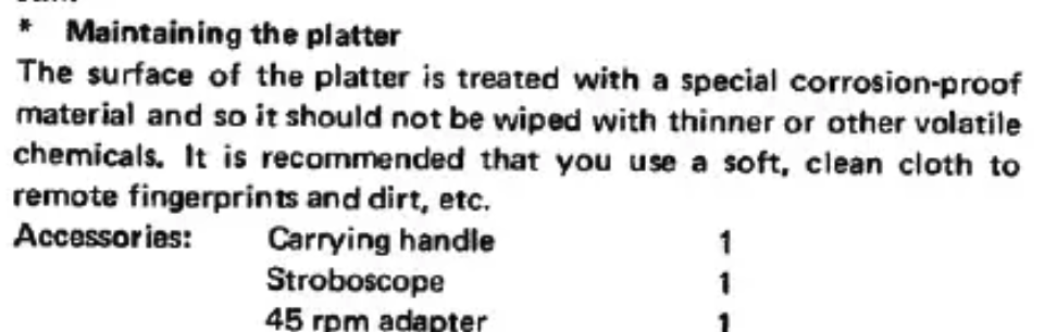

Hi,
Could you please validate this information?
Couldn't find any information regarding "special lacquer to prevent ringing."
In the RX-5000 manual it's stated:
btw,
the 1500 in the photo have a polished platter.
Hi,
btw,

Is there a way to re-apply the special corrosion-proof material?
