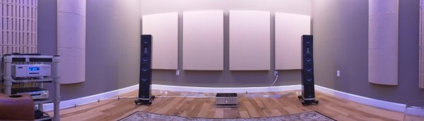

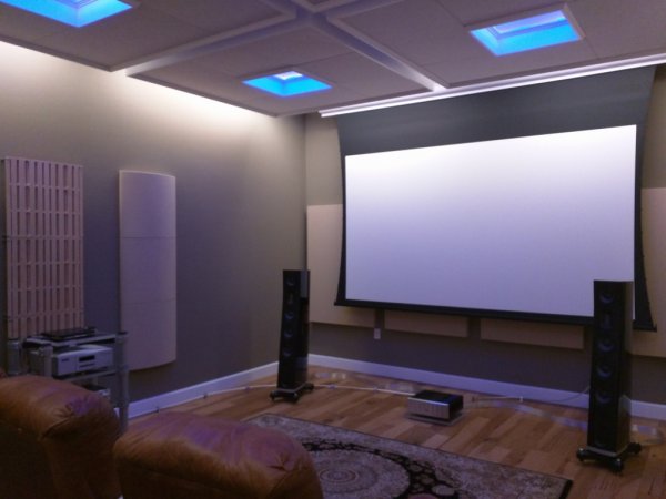

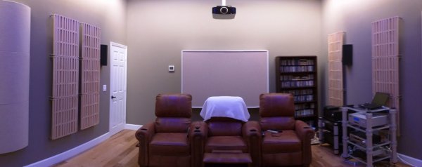

I used Acoustic Frontiers (Nyal Mellor) to design and measure my media room. Nyal utilized the "acoustic clouds" originally designed by Rives Audio when my system was in my FR. The room is acoustically controlled but still live.
Nyal is based in California but can effectively measure your room by sending you the measuring hardware and analyzing the results.
http://store.acousticfrontiers.com/About-Us.html
Had the opportunity to discuss with Nyal. He'll be the person for my next room.
