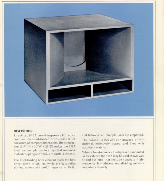

Small monitors are not horn loaded, this is irrelevant. Physics stand, even 150hz full horn loading means about a meter wide mouth the least, and about a meter depth.
75hz of Leif's midbass is great and there can be many solutions that will work great below 75! You can have folded horns, tapped horns, even large horns that are a little out of alignment, it wont be heard that much at around 75hz.
The 816 is horn loaded from 200hz (see attached reference sheet), I would be very surprised if 817's are horn loaded an octave below! How did you measure, can you chare the impedance measurement for us or do you think you are able to distinguish just by hearing which frequencies were horn loaded?
Increasing the box size will give you lower frequencies but they will not be loaded by the horn. The horns depth, throat and mouth size sets the frequency to load, the lowest you can reach is its cf point if you reactance annul. For ex. my mid-bass horn which has little more than 1 meter mouth and has 1 meter depth, with a reactance annuled back chamber can go as low as 110hz.
All monitors play below that but I do not get what it has to do with anything. The mid-bass I have is 109db efficient to its cutoff, that is why it is that size.
Reactions: Folsom and marmota
Sorry about the capture, here is a better one;
816 is one woofer. No, don't have measurements.
When you increase box size, why can you not increase depth and mouth size
When you increase box (rear chamber) size, why can you not increase depth and mouth size
You can increase the depth and make the mouth bigger, that means you are building a new and bigger horn, and that is the way to load lower.
If you just increase the rear chamber size, the you get direct radiated bass from the driver but it is not horn loaded.
The better way to do it has been found so long ago, and is called reactance annuling. You actually turn your woofer into a kind of compression driver :) You adjust the fc of to fs and gain about half an octave of more loading down to cf! To do that, I built my backchamber out of slices, so it was adjustable. I took of one slice at a time and measure the impedance and continue until I got it right.
It wont go as low as building a bigger box and with annuling you actually end up with a very tight chamber but with the benefits of horn loading and lower extension than before.
