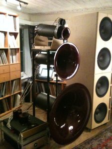

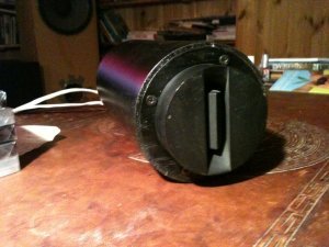

by rotating the TAD 703, they can in a certain way influence the perceived soundstage height, width and depth and minimize diffraction issues
I did the same when I rebuild my AG Trio to Quattro by adding a JBL 2405 ring radiator tweeter with a "slot horn"
