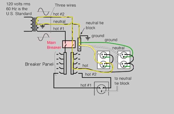

This is how AC systems actually look. Yes, as Speedskater says it is really only a single phase. However the phase gets split (center tap) so that you can have 120v instead of 240v. This gives you two effective poles that are "hot" (Line). These are the alternating spots for breakers that Ron mentioned.
Neither is positive and neither is negative on the poles. As you can see each pole has 360* of phase, and it flips between "negative & positive" every 180* there for there is "phase" because it is alternating (AC) up and down at 60 times a second (60hz). The neutral as you can see by itself cannot complete a circuit by connecting to SG (safety ground, the one connected to ground rod), because the path doesn't cross any of the transformer windings (SG & neutral are connected). But for both Hot poles (Lines), you can see that if they touch the other Hot, or SG it makes a complete circuit that includes the winding of the transformer. In this picture there is a primary and secondary winding, and the CT splits the secondary winding in two.

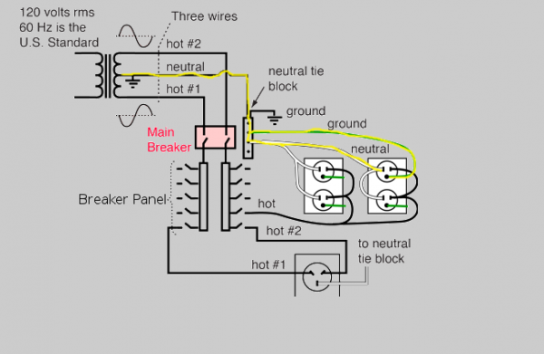

Here's an example of how Neutral cannot make a path through any windings of the transformer to complete a circuit that has power:
Here's how a normal connection is made for 120v that will complete a circuit through the transformer:

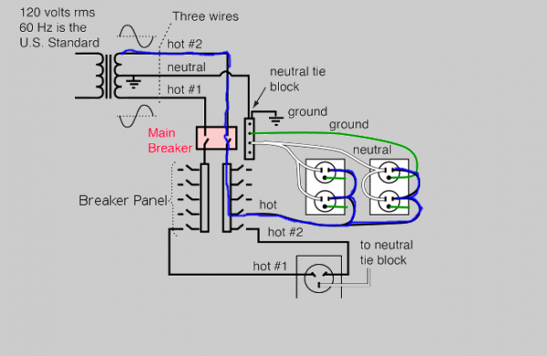

Here's how the two Hot poles can make 240v completing a circuit through the entire phase of the transformer:

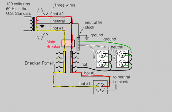

Ron Resnick: Again there is no positive. What your electrician is wanting to say, were he to understand it much better, is that you should only use 1 pole (1 Hot side of the transformer 120v) for the whole stereo. This is a decent idea for a few reason. Here's a drawing where you can see only one pole is used for the sockets. Please note that in a real breaker box the poles are mixed every other.
What a real breaker box looks like, as you can see the poles alternate. This is because the part in the middle that rises up connects to breaks on left and right at the center of the breaker box.

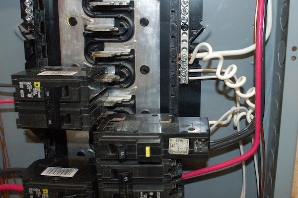

Here you can see how left and right breakers attach to the same pole, and alternate above and below. Each big bus bar that rises to connect to breakers in the middle is 1 pole, 120v worth of a 240v single phase. A 240v Breaker is a double stack that connects to both poles, and is used for things like your laundry dryer and oven. You can see one in the photo top left, where red and black are both Hot, Line 1 & Line 2. The white are the neutrals. (coily white is for a GFCI sensing breaker, which are for bathrooms)
