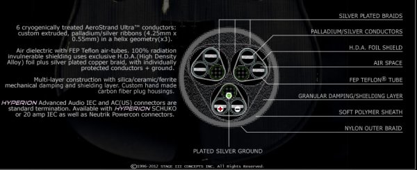

These are the cords in question , Kraken from Stage 3 Concepts , look up the vid at the start .
Wow they sure have technology in those cords. May I ask what brand and about how much for one. ? If you wish you could PM me. I have used and do use hi fi grade inter connects but not a power cord. I tried a ps audio jammy and it made a big difference and one unit can do many devices so it made sense. But enough people swear to cords I know there must be something to it.
I have a USB cord that uses a two batteries in it , audio quest something.
Al
They are the famous Kraken costing $8400 - no need to PM. I hope we do not get insulted just because we are debating them. :(
http://www.monoandstereo.com/2014/02/stage-iii-new-kraken-power-cord.html
http://www.stage3concepts.com/PRODUCTS_Kraken_page.htm
