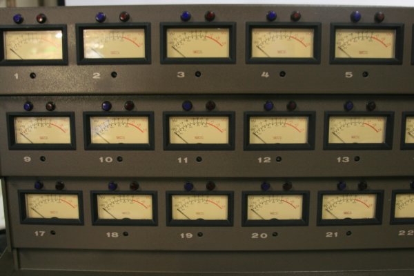

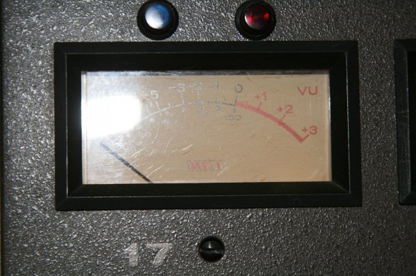

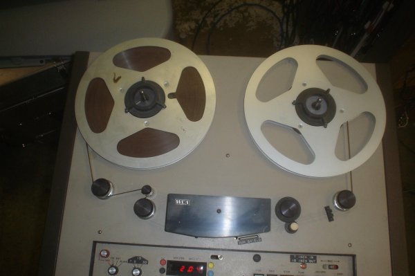

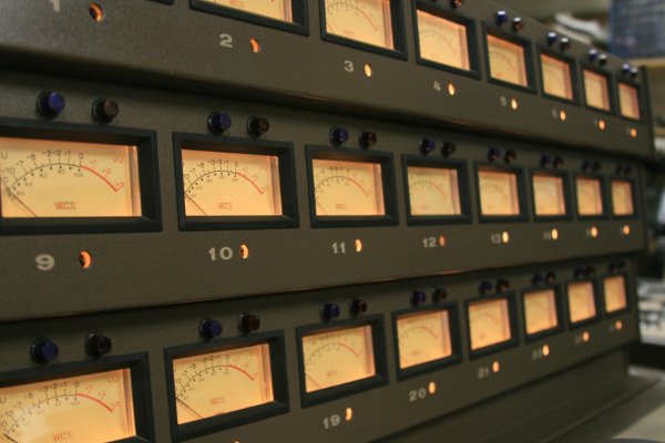

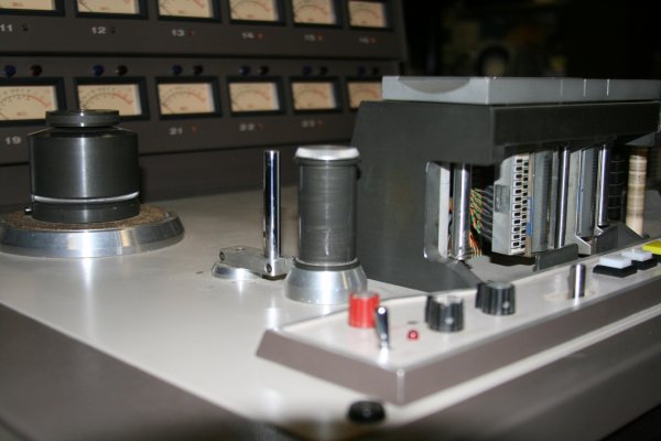

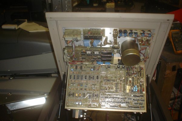

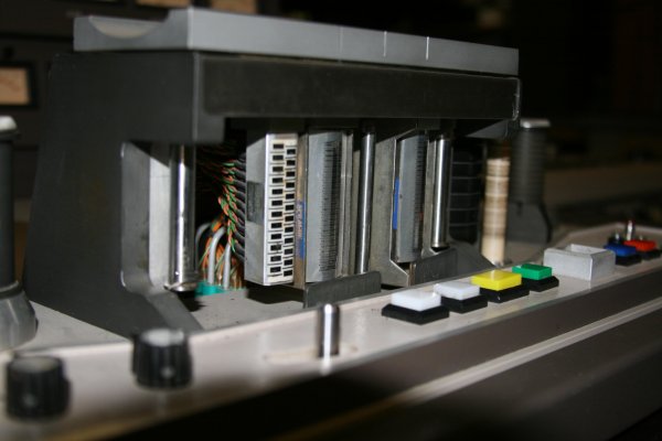

Just thought I'd share a couple of things sitting at my place right now. Both are MCI machines, dating from the 1970s. THe 24 track belongs to a local radio station jock (for lack of a better word, sorry!) that I sent a fluke email to. He's been in Vancouver for years, and he has formed a company where they take old master recordings from the 60s and 70s of bands and musicians in Vancouver, and restore and remaster them. He was featured in the local newspaper with a gorgeous old reel to reel machine. I shot him a message through Facebook, offering my technical services if they ever had any machines that would go down, and of course within 2 days he'd contacted me, saying that he had the 24 track with a takeup reel issue. 4 trips to his place across town, 1 trip to lug the 250lb beast to my shop, and an 8 hour day today spent learning the machine, and it's back up and running.
I did a lot of work with the power supplies, repairing bad solder joints and changing old caps out. I got rid of a couple of intermittents along the way, and the main problem was a bad chip right within the capstan motor. Enjoy:

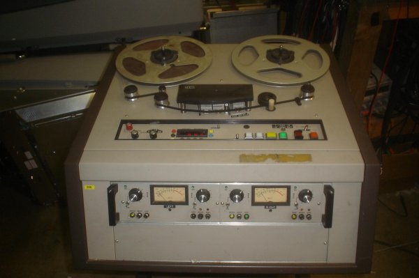

As for the 1/2 track unit, I bought it locally for $100, and then it sat gathering dust for 3 years. When I got the 24 track in, it inspired me to power up my own unit, and it turns out that all I can find wrong is the tape shutoff optoisolator. I've got one on order, and at 7 1/2 IPS, it's flat to past 20Khz! It also does 15 and 30 IPS, and I can't even imagine what the frequency response is, as my Nakamichi analyzer only goes to 20Khz.
