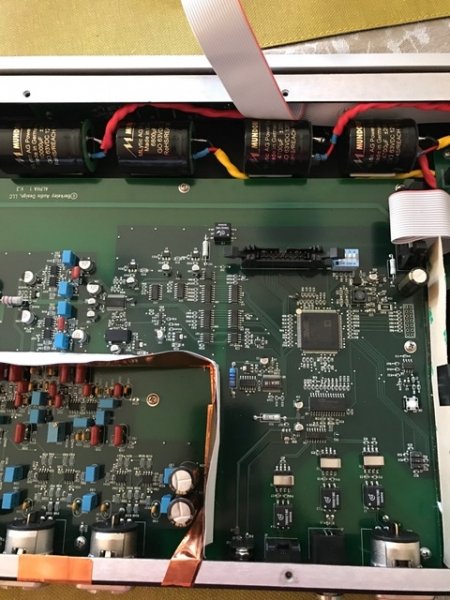

This is the latest round of DAC modifications, this time around the power supply, using Mundorf Mlytic AGs, which offer exceptionally low ESR and ESL. The DAC was definitely struggling with very large scale program before, like the Mahler 2's Finale, where the chorus had a bit of grain, the soprano was kinda shrieking, etc... More details on the sound later on, but for now, I will make a rather large claim, that this DAC/transport has now probably reached or exceeded the previous generation Spectral SDR-4000SL in performance... which means, I expect the 4000SV to outclass it. On the same Mahler Finale, the Rossini was still better, with more authority with the organ, and in general, offered a larger scale presentation.
This is a rather involved modification due to the tight space and low board clearance, but after 8 hours and a lot of planning, it worked. Just making the cables took a long time...

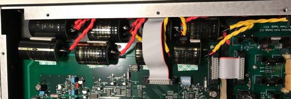

I have doubled the power supply caps from the original modification, as shown below, after careful listening with large orchestral and especially organ. I feel comfortable in saying that the transport/DAC is now far superior to the older Spectral 4000SL. The increase in low-end control, freedom from congestion with complex material, and increase in dynamic headroom over what came out of the factory is just staggering. Coupled with the noise reduction in the output section, this is really a totally resurrected DAC, and I can't stop listening to digital.
CAUTION: Don't try the power supply mods at home if you don't know what you are doing, and space is extremely tight; also, the current draw is now probably significant enough to create fireworks and destroy the power supply, if you accidentally short things; and you probably have to increase the fuse's rating, and I simply bypass it - dangerous any which way you look at it, but I know what I am doing.

You can tell the size difference in the pictures in post #221 above - quite larger indeed, and recall, Mundorf uses double caps inside to get the low ESL and ESR. I'll have you over next week, just need to find the time. Right now, I need to install a small fan to circulate air inside.
