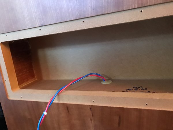

ack, many of your components are modded. Some, like your speakers, are heavily modded. How come your REL Stadium III still remains in its rather primitive stock state? I own a pair of REL Stentor III and have already put them through 2 phases of modification with outstanding results. Phase 3 is due in February this year. When and if you open the back plate of the sub, you will be appalled with the primitive parts there. I threw all that out and put in the good audiophile-grade parts instead.
I am new to this forum and don't know how to attach photos. Can you tell me how? Or give me your e-mail address to send the photos of the mod job done on my Stentors. I have an excellent engineer who's been modding the **** out of my entire system with outstanding results (I'm a linguist, not an engineerHow exactly did you modify yours and who did the mods? Don't tell me there are more electrolytic caps in there :-(
I am new to this forum and don't know how to attach photos. Can you tell me how? Or give me your e-mail address to send the photos of the mod job done on my Stentors. I have an excellent engineer who's been modding the **** out of my entire system with outstanding results (I'm a linguist, not an engineer). The subs are 80% complete. Hopefully by early spring he'll be totally done with them.
Regarding electrolytic caps... In the Stentors there are 4 large output caps in each sub of poor quality. We threw those out and put Mundorfs in instead. Replaced 2-cent speaker wires connecting drivers with PCB with AQ Mont Blanc cable (soldered to the driver, of course!). Replaced stock power inlets with Furutech. Replaced crappy wires connecting Neutrick inputs with the PCB with PSS conductors taken from AQ Fire interconnects. Bypassed Furutech power inlet with Mudorf Supreme cap (1mF) and added a truckload of Audyn Cap Plus caps into all types of power circuits (around 100 mF into each sub).
If you do the same to your Stadium, you will forget about Magico S forever.
The capacitors are high quality nitrogen filled polystyrene types of 1% very close tolerance and an indefinite life. The use of very close tolerance components also ensures consistency of performance throughout the production life of each model. Great care is taken over the star earthing to maximise sound quality. There is further filtering of the higher frequencies to ensure optimum performance at all settings of the ABC. The built-in power amplifier is built onto a separate circuit board and uses ultra rugged audio grade MOSFET output devices. The power supply is the engine house of the amplifier, the smoothing capacitors [ack: those Aerovox] are long life with very low equivalent series resistance (ESR), the bridge rectifier is very conservatively rated at 35 Amps. The transformers are ultra quiet audio quality toroids with very low losses, these are especially manufactured to our strict specifications. Great care has been taken to deliberately over engineer all REL products to ensure ruggedness in service. This ensures an exceptionally robust, long lasting device.
What's exactly wrong with Aerovox in this application??? Plus, they are supposed to be extremely high performance. You do realize these are expensive film capacitors, not your typical electrolytics. I also play the sub at extremely low volume, crossed at 25Hz. I am thinking I'd rather see if I can get an S Sub for $10K or less.
Thanks. I will call the US Aerovox tomorrow, they are 20 mins away from here, see if they can look up by part number to confirm or refute. On the board, though, these caps are bolted on, like you would any US Aerovox of that size (they are HUGE for their capacitance and rated voltage, much larger than the 10K uF/63V Mundorfs I put in the DAC, making me think they are film, not electrolytic).
