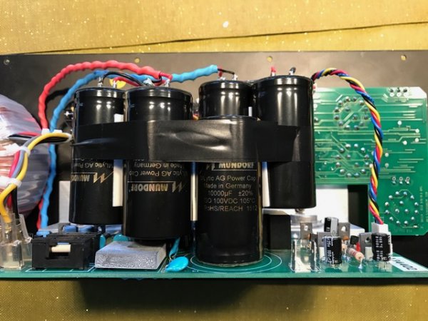

On the REL mods: I mentioned there are three electrolytics in the bass summation/amplification circuit that I didn't like, and these Daewoo have now been replaced with much higher quality Nichicon (10% tolerance). I have never heard such tight bass from the sub. I don't know if I am done yet, but I am probably done with REL subs going forward.

Here are the pictures; I ended up installing a total of 6x10,000uF PS caps (5 are clearly seen, the last is sort of hidden, facing down in the back), plus the three black Nichicon seen on the right hand side. The two PS Mundorf facing down were secured to the board in order to withstand the additional weight of the other four. The caps are attached to each other with two-sided tape plus the electrical tape. I have not replaced any cables.
