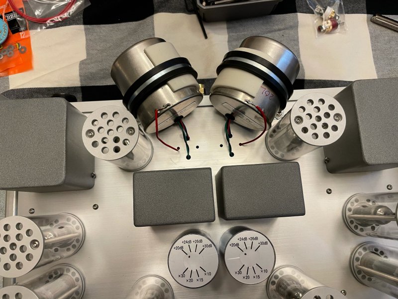

Ended up doing a few more mods:
- Removed internal input board
- Removed stock SUTs
- Removed impedance switch
- Installed Intact Audio Silver SUTs
- Installed 220k 2W Audio Note Tantalum Silver resistors
- Removed XLR outputs, now it goes straight to the RCA outputs rather than the XLR and a switch
- Input and Output RCAs are now WBT Silver
- Removed stock grounding post, installed a Cardas ground post.
- Used all Neotech Ag/Au 24ga Hook up Wire, Mundorf SG Supreme Solder
- Tried to shield as much of the signal paths with Mumetal
- Ordered a copper plate for the bottom of the chassis, for fun, don't have it yet.
All-in-all a fun job. Sound wise, as you would imagine, more detail and much better tonal colors. Everything is better. The unit is about as quiet as the stock version. I will likely experiment with further shielding of the SUTs and start thinking about the power supply.

All changes so far been very positive. Since the last post, I wired the RCA Outputs directly to the Output Transformers, eliminating the Mute & Phase switches and associated headers. I also replaced the bottom panel with copper. For feet I compared Stillpoint SS and Herbie's Tenderfeet. I preferred the Herbies.
I see this as a fruitful project. The base H3000 is fantastic, especially with the KR RK Recti. If you are looking at having some fun, and don't need all the flexibility of the unit you can essentially turn it into a MM one input, RCA only out and it takes the unit up another notch. With the above mods, the tone is gorgeous and the new detail coming through is mesmerizing.
Next up, I have plans for the Power Supply and a new/ special Rectifier.
