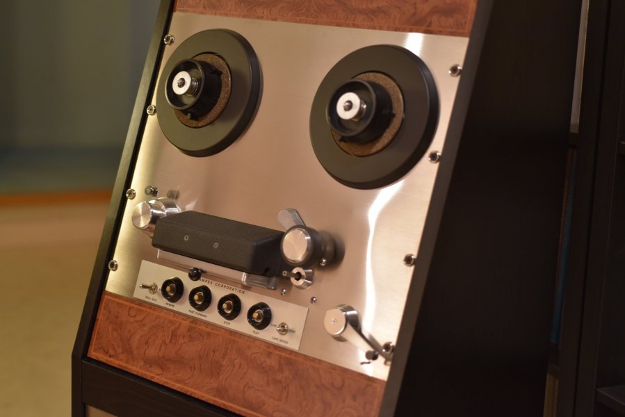

My Ampex rebuild project progression: Reel motors on the place everything aligned and working good.

Thank you, I appreciate your comments. To answer your question, sigitask, yes there are conventional steel rack type rails attached to the insides of the enclosure. I was very fortunate that the bottom section was exactly the needed dimensions for mounting the two electronics sections and that the mounting holes lined up.
Great beast, and really nice burl - that was a good move!
How much, do you think this machine weighs? I would guess about 150lb?
