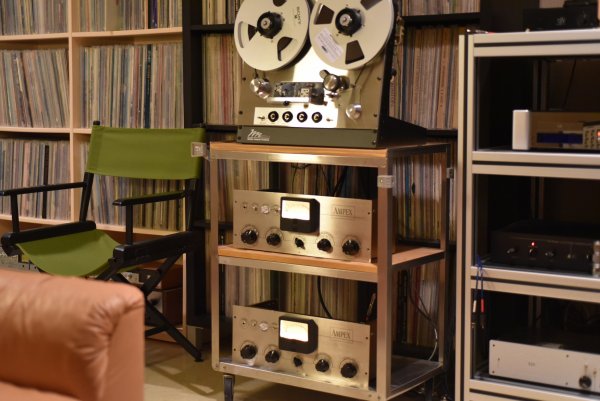

My overall plan was to first get the transport section looking and working as perfectly as possible and to try and improve on the tape handling aspects of the 1958 era design. The transport is fairly easy to dissemble, the three motors are removed from the central control box using Cinch-Jones type plugs and unbolted from the main mounting plate. I had managed to find NOS supply and take up motor assemblies and decided to send the capstan motor to Dave Dintenfass at Full Track Productions for an overhaul. I wanted to convert the transport from a constant torque design to a constant tension system at least on the supply motor. Fortunately I was able to source an Inovonics Tentrol 400 that I was able to get operating and installed. This system uses a tachometer attached to the supply motor assembly that varies the motor's operating voltage as a function of the amount of tape present on the reel. The result is a constant and adjustable level of tape tension throughout the complete playback.

Yes, that photo was taken after I'd replaced all of the push buttons for tape control, both take up and supply motors, had the capstan motor rebuilt and installed the tape tension control assembly. This photo shows the front of the machine with the NOS faceplate I was fortunate to find.DSC_0079.JPG
Now that the transport was finished and the high impedance playback head assembly was installed I could begin work on the electronics sections. My goal was to first rebuild the power supply on the least damaged unit and get it working properly and learn a bit about how everything was put together. Then I could focus on the remaining two units that were needing the most amount of refurbishing. After doing this I was able to disassemble the two chassis and have the pieces of the enclosures sand blasted and powder coated with a finish as close as possible to the original. The same company was able to photo engrave the lettering on the back panel. I then removed all of the components on the six circuit boards, ultrasonically clean and rebuild them with new parts.DSC_0063.JPG

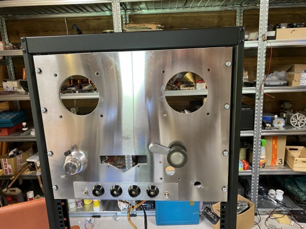

I refurbishing also one 350. But it is not so nice like yours.
