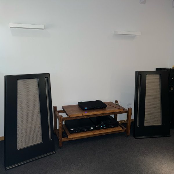

Hi everybody,
I recently found a pair of Caliper Signatures at a local hifi store at a very good price. They had sold this very pair pair new, back in the day, and got this as a trade in.
The cabinets were painted and everything looked fine, except the sound was awfully dull, no treble at all. Tried the hi/med//low knob but only minor differences still dull at all positions, tried changing tow in/out and inclination also no help. Jumpers cables ext...
Definitely not the sound i remembered from the late 90s with the Krells and Wadia combinations i was familiar with back then.
What can be the problem? I was interested in building a small system at my summer house.
Th picture is from the ad, but not the system i heard it (the actuall systme was Musical Fidelity pre /power M6, Metronome C/Aqwo dac).
Is there something i can do to get this fixed or should i skip?3765360605.jpg

Did you put your ear up to the ribbon mid/tweeter to hear if they actually made sound?
Have you double checked the shorting bars are in place and/or your jumpers between the MRT and Woofer inputs? The two sets of speaker inputs must be connected by one of the two.
Yes and yes, this audition is at a hiend shop. We even used hiend jumpers.
Do you think it is a crossover issue or a matter of the magnets gone bad after all these years? or something gone wrong with the disassembly to get painted?
The shop wants me to buy them, and i should go to Analysis for service and repairs. (I am situated in Greece so Analysis is very close by)
I would like them to have them serviced first but they assume that i should buy first and then have them serviced.
I think i must skip but the price is really good, even if i should add some repair and maintenance costs, but at least don't you think they should accommodate me with that?
Magnets don't “go bad.”
In short, if they don't sound good, don't get them unless you're willing to spend whatever it may cost to fix them.
Whether spending that money is something you want to do or not, only you can answer - but do you want to take that gamble?

The question is when a reputable shop does a trade in and then resells the items shouldn't they fix it and then make a price for a properly working item?
The price is irrelevant, the principle is of importance.

The fact that the shop wanted you to buy them, then have them repaired was a huge red flag to me; of course any store selling a trade-in should make sure it is in proper running order first, otherwise you may as well buy a pair on eBay.
Personally, I'm staring at a pair of Caliper Signatures right now, they're the speakers for my bedroom system but I purchased them new in 1993 and they were redone with Graz ribbons in 2010.
