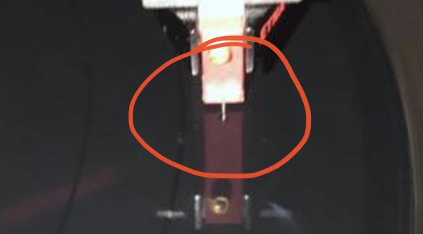

- check the cantilever deflection at various positions with a record playing and notice the reflection image, see below photos of my ETNA. The first photo show inadequate antiskating, the second photo adequate.
make corrections by adding or removing orings.
