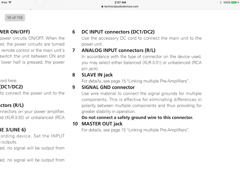

Thanks for the detailed reply Amir. Just to clarify your solution two "connecting TAD C600 ground connector (back of C600) to wall earth wire" doesn't conflict with "Do not connect a safety ground to this connector" from the bold print in the manual?
I guess what I'm asking then is "wall earth wire" the same as "safety ground"? And other than the difference of dynamics you experienced, is there any other sonic detriment to using the C600 ground connector with a signal ground system like CAD or Entreq? TIA image.png

Soulution 2: No it has no conflict because when you connect (for example) Weiss DAC to TAD C600 then all TAD system D600/C600/M700 will connect to the safety earth wire through the Weiss AC wire.
If TAD recommends us to connect C600 back connector to other components it is about having better connection between chassis of different components as you know the connection of pin1 of XLR may be not very low impedance. This approach is also recommended by russ andrew company in uk to have better connection between chassis of different components .
Yes , "wall earth wire" is the same as "safety ground"

When you connect the device to Wall AC the third wire in AC cable (ground wire) will connect the chassis to safety earth and the voltage drop to zero and you will have a dynamic current between device chassis and the earth. TAD believes there is no need to connect the device to safety earth and I think their opinion is 100% right .
you can see the TAD Engineer response to this subject
Reactions: Stef

It would be nice if the TAD Engineer addressed SIGNAL ground and why their superior engineering led them to put a ground post on the back of the C600?
