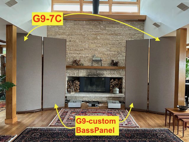

Happy to respond...I'm not entirely sure I'm understanding or visualizing all the right things you are asking.
1) '5cell SL speakers in the house' - I'm not sure what this is referring to. The bass panels are in the photo I am attaching here.
These are flat panels - it does have bass focus and distributed resonance same as the full range panels. Please be sure to understand that the 'spacing' for a normal unit is NOT for mids or high freq at all - the spacing is ALL for lower frequencies basically 200hz and lower. Therefore as the bass panels are only for 200hz and lower, the same spacing to achieve bass focus and distributed resonance are the same. The panels can be flat, because sound waves lower than 200hz have no 'beam' and resonate thru the room without requiring any angle dispersion.

4) the bass panels (don't really want to call them 'subs' because they are not intended to be used as 'sub-woofers') - they add energy to the room and my living room is very large and opening to other rooms with a very high ceiling. They do make a difference, but certainly not necessary. They do require careful balancing with controls. (that discussion can be later if there is an inquiry)
Here's the backend equipment.. The PSA M1200s and Classe Delta Monos are not being used currently.
