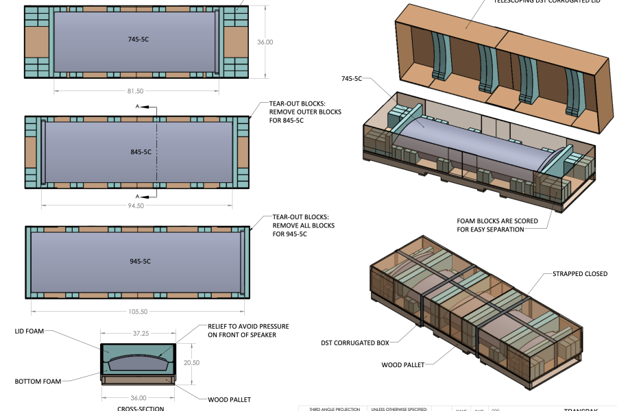

Another note: I have had packaging redesigns worked out which hopefully will be much better, lighter and cleaner (no white styrofoam that flies in pieces everywhere) The first try will be for moving demo speakers from SL to California Audio Show next month. Photo attached to give an idea ... comments/questions welcome. This design is intended for three heights of speaker G7, G8 and G9. (all same C5 width)

Folks mentioned this ad for a 945PX earlier on this thread. The dimensions look really large. I’m guessing this would require a moving company with several strong people to remove and install this speaker. Not a task for the faint-hearted!
Sorry i meant to send the video to you because I think you might have been the original wondering about how to move and set up? The new packing material however would not apply because I have not yet designed and made for the standard 7 cell width model (which is your 945PX you are referring to.
