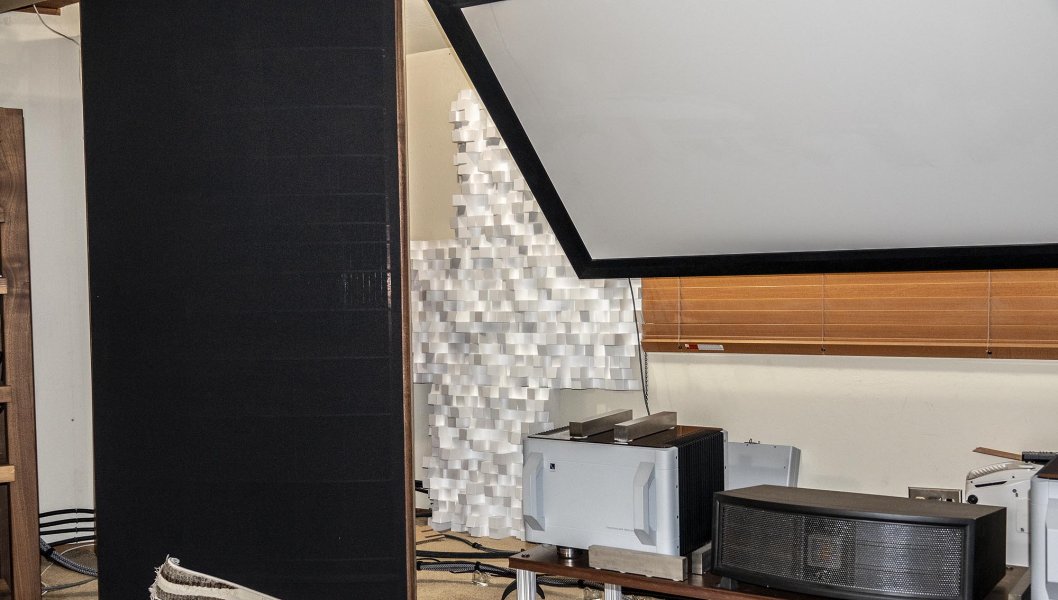

I've removed the 6'x3'x6" damping panels from the left and right of the front wall and have temporarily stacked four 24" square Vicoustic DC3 diffusion tiles by merely leaning them against the wall; I expect that removing the damping panels will enliven the room a little.
It NEVER ends...
