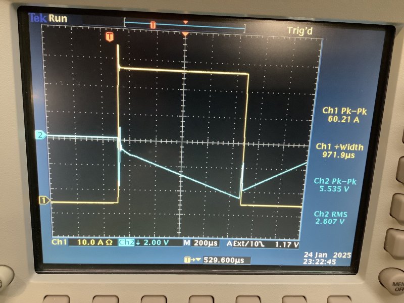

I am liking my newest version of my active load. The design plan was lower noise on my current drive, differential outputs for measuring and a full 1Mhz bandwidth. Plus a 0.05 ohm output impedance. I was also after very low distortion, so I can now measure harmonic distortion of power supplies and in circuit regulators in gear. Im sure no one has done this.
So I am pretty confident now that i have the best tools ever made to work on power supplies and regulators. You have to be able to see what your doing to do good work and I can now see and measure things in unprecedented detail :)
The active load can do 100 amp pulses. So 60A is easy.. Of course at 60A doing a sq pulse, there is 5V of noise, hahaha..
So 5mA to 100A.. 0.5V - 60V.. DC/0.01hz - 1Mhz. 0.05% THD.. I am quite happy.. 2 months of work. This will enable me to do more fun things and will become a invaluable tool...

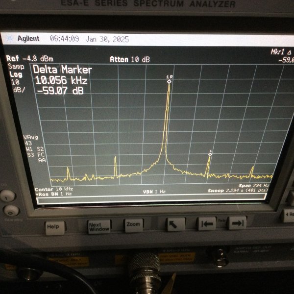

OOoOOooo.... I can now easily measure harmonic distortion components of a power supply or regulator... Going where no one has gone before, hahaha.... So the noise components from a 1A load on this power supply has harmonic components 59db down in the noise. Which you would expect, but, fun to easily measure it and be able to do so at any frequency or load.

Well so far after playing with it on the ATVX and Switch X,, these look ideal.. One of my vids shows the linear I already use. I already know the ATVX I cant tweak any better, I spent forever on that. I have had a active load for a decade, its not new to me, this one is just better. Measuring my current linear was fun tho, the specs were impressive. Better then I measured with my old setup.
The ATV has a few key things in the power supply path. It has a cap bank that has 3 different types of caps and these are arranged physically along a set of pure silver wires into whats called a strip line filter kinda arrangement. Its SERIOUSLY tuned. The positions along the strip line and the size types of caps was fairly straight forward to figure out and my old active load was magnitudes better then required. So its all crazy good.
I was able to do 60A pulses thru it and confirm some things tho :) So the new active load was fun to play with. I got the 18ga solid silver wires hot :) with high freq pulses :).. I was able to more quickly confirm the tuning.. The caps are also a time domain thing, so I was better able to see this alignment.
