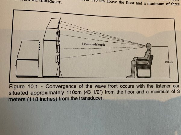

Avalon pretends that the listening position should not be directly on the back wall, which I think should be taken for granted. For me, the space is also determined using the Wilson Audio "Zero Pressure Zone" method and is accordingly far in the room.
The Osiris has a predetermined inclination when the mid-high element is level,
Avalon accordingly specifies the following listening distance:
The distance between a loudspeaker and the ear of the listener should be 300m for a measured ear hight of 110cm. With this distance, the speakers' chassis would add up to "one".
A few pages further on, we speak of an ideal listening distance of 400cm with the same ear height....
My measured ear height is 80cm,
at 300cm speaker base distance my distance to the respective speaker is 430cm.
From my experience adjusting the pitch of the mid-high units, I would say that my ear may be too low. At least if you assume 400cm as the ideal distance. Now I could push the sofa back a little, or change the inclination of the mid-high unit using the rear adjustable apex spikes and thus tune to the listening position.

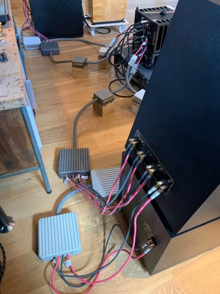

After a few hours, the first music comes out of the speaker :)
The connection with the MIT EVO 850 speaker cables was more complex than expected, because the TriWiring pair is relatively short. At least when you consider the unwieldiness of the heavy aluminum boxes.
The Avalon Osiris has 5 speaker inputs, which means that you could theoretically control the speakers with 10 monoblocks.
Avalon recommends the use of 2 stereo power amplifiers in the manual, each of which can be assigned to one channel, quasi-vertical bi-amping.
I'm not there yet, so my Jeff Rowland M825 stereo power amplifier must be sufficient for the time being, maybe there will be a second one in the mid term future.
The M825 has 2 speaker outputs per channel, so that one set of triwiring and one set of biwiring cables can be connected.
I had previously considered that I would like to have the frequency ends fed by the BiWiring cable. At MIT the cable ends are labeled in Low, High, mid, etc., so that Biwiring Low is now connected to the bass crossover and Biwiring High to the super tweeter crossover.
Accordingly, the triwiring cable is divided between the mid-woofer and the other two tweeters.
In fact, the aluminum boxes facing the amplifier require a base, otherwise the cables cannot be connected.
At that time, the MIT EVO 850 cables were developed by MIT together with Neil Patel as technology support (among others) at Osiris, so I will not try any other cables for the time being.
With this MIT wiring behind the power amplifier and loudspeaker, the cable mess definitely takes on epic proportions.
Now let Osiris have an hour of music to arrive and warm up, then I'll listen to the speaker.
View attachment 66675View attachment 66674View attachment 66673

the Osiris concept sees the tweeter working from 300 cm minimum distance, better at 400cm distance.
The problem at the moment are the furniture rollers, which make the speaker around 20cm higher...
