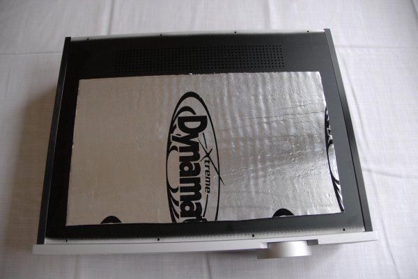

I mentioned that I would post photos of my old TacT 2.2XP AAA and the new one which has Anthony's latest modifications or refinements. Here they are.
First, here is the interior of my totally stock TacT 2.2XP AAA which I purchased new from TacT in, I think, 2007:
Next, here is the interior of the new 2010 TacT 2.2XP AAA which I recently received from Anthony Padilla with his latest full modifications/refinements. (Bending the front and back panels of the unit into a perhaps-pleasingly curved shape is not part of Anthony's modification, by the way. That's distortion from my not-so-wonderful Nikon wide-angle-to-telephoto lens at its extreme wide-angle setting. I could fix it in Photoshop, but I have better things to do, like listening to music on my newly upgraded system):
Finally, here is another picture of the new unit with the top cover upside down so that you can see the Dynamat Extreme which Anthony has attached to the inside of the top cover.
This same material coats the left and right side walls of the chassis also. While you can't see it in these photos, Anthony tells me that Dynamat is also under the motherboard, and that the chassis has been reassembled with a light coating of silicone to eliminate harmonics. These steps solve the ringing which the older stock unit exhibited. I have used a Bright Star Audio Little Rock on top of the old TacT unit to solve the ringing problem. The Dynamat Extreme seems to have a roughly equivalent effect, judging from my ultra-scientific tap-your-finger-on-it-and-listen-to-what-sound-you-hear test.
As you can tell, there are a lot of new and different component parts in Anthony's refinement. I'm sure others here will be able to tell a lot more than I can about the nature of the modifications from examining these pictures. Have fun.
