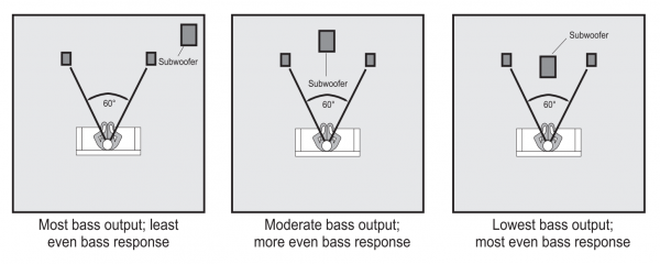

So bass is mono in the recording, it's directional because of room interfaces, and less directional as you free yourself of adjacent room surfaces.
I set up my room like the above diagram (unknown original source), and it works, it's the only thing that has ever worked for me.
Lots of reading also lead me to believe the lesser of evils is using Low Line Level IC's inputs from a dual output preamp verses speaker wires to High Level Inputs.
Barry Ober says use a real crossover after the preamp and don't get upset about putting more stuff in your signal chain, if you only knew how much that signal has gone though in the recording process it would not be so precious to you.
Sorry, I got it to work to my satisfaction without another box and more wires.
This is interesting for sure. The only problem I see for my setup is that my amps are in the middle where the sub is depicted in the diagram. I have tried the subs on the outside of the speakers facing the front of room, and then faced the subs towards each other to reduce the level of bass power and create a better fit to the speakers and listening position. As others stated, it’s an art to get subs dialed in. Now, I don’t use them much at all since I obtained my new speakers, the Classic Audio T1.5 Reference horn speakers with field coil drivers.
My sub is now setup like the third picture on the right. It does indeed provide the smoothest and best integrated low end I have had on my current room. While it may have less inherent output in that position, I have no problem adjusting it using the sub controls.

Finally in 2019 I bought a JL Audio F212v2 and the CR-1 crossover. JL Audio T/S helped me with positioning and setting the phase degree for my room. The bass sounds like it's an integral part of my stereo system.
I'm now listening to music with a palpable low end. And because my stereo amp has been relieved of supporting bass, the mids and highs from my stereo speakers has appreciable improved.
