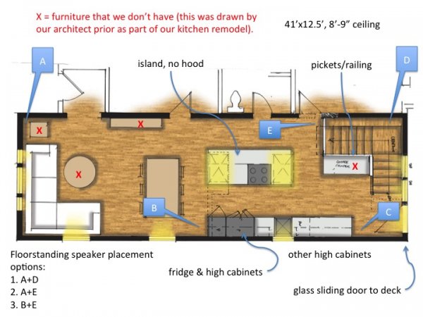

Hi,
I wonder if anyone has ideas on how to best place floor standing speakers in an oblong room that houses an open plan kitchen (island + bank of cabinets along one of the long walls) and a small living room.
We currently have a pair of very basic book shelf speakers on the cabinets that surround our fridge, placed roughly in the middle of one of the long walls. We heard a pair of floor standing speakers and found the sound engaging, and made us breathe differently, more openly. But we're not sure where to place them?
Enclosed is a plan view of our kitchen. Any thoughts welcome.
Firing across the room from the long wall is normally better than down the room.
I would start with either side of the two windows in the bottom left and put them on stands.
Would you consider rotating your white couch 90 degrees, so it runs along the bottom of the page and then up/parallel with your dining room table? Then put your speakers in A and the opposite corner (bottom lefthand of page)?
That might make a very logical placement for 2 speakers, and if you can get the couch right, give you a comfortable seating around (again logically around the music), as well as maintain the rest of your living/dining space.
An oblong room for cone speakers on the short wall is going to have a lot of side wall reflections, unless you sit close in.
There is no room for horns. So the other choices are a corner speaker like Tannoy/AN-E (not my taste), or you can have panels on the short wall, but the rear wave should be reflected off the wall and not be lost through that window. Not sure how much space you have on the wall before the windows start.
But I think you will end up sitting pretty near field either way.

The room is approx 41' long x 12.5' wide x 8.75' high. Hardwood throughout. (It's not a large space by US standards- but it's the SF Bay Area, you know, where housing is like antique jewelry.)
Another plan view with a few dimensions is below (the couch is smaller than depicted in the drawing).

What you heard wasn't just a pair of speakers it was a whole entire system and that's really what you need to upgrade, you don't have to be an audiophile to enjoy better sound. Your system is very basic and its not going to take much to drastically improve your sound. The following is what I'd recommend for you, the red X is where I recommend to place the speakers if you went with the JBLs. They're wide dispersion horns and should be able to fill up your space with great sound without breaking the bank.
