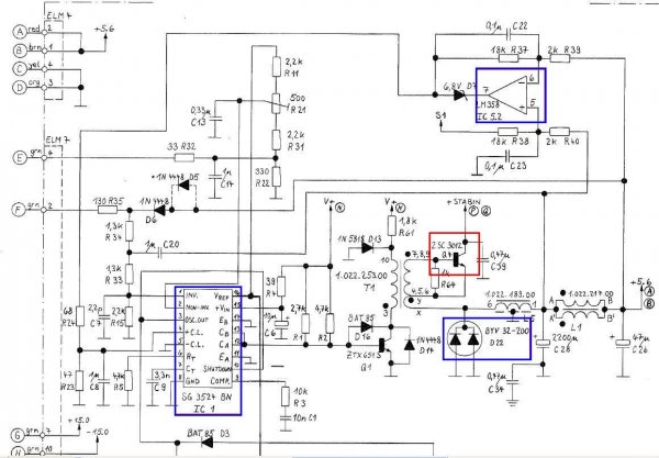

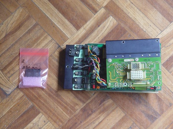

Recently my A820 suffered a nearly complete black-out: no response, no light except green LED's monitoring still healthy supply voltages. The problem was diagnosed to be a blown transistor 2SC3012; resulted in missing of 5.6V supply. Here Greg Beron would inject his idea of external pure DC power supply to replace A820's original highly efficient switching power supply (more precisely DC to DC converter; actually this part of circuits was called stabilizer ).

As a non-DIYer/non-tinkerer I find that scary, yjwu!
It is good you were able to track down the problem component!
Thank goodness for Ki, Charlie Bolois and Marc Bischoff!
It was a scary moment indeed! Fortunately it was a single component fault, no collateral damage. With STUDER's detailed service manual tracking down problem was not that difficult. Related components were clearly marked in block diagram. Checking each of them soon revealed the culprit. Another big thumb up was that most critical components were socketed. I can swap IC's from different supply branchs to confirm their status.
