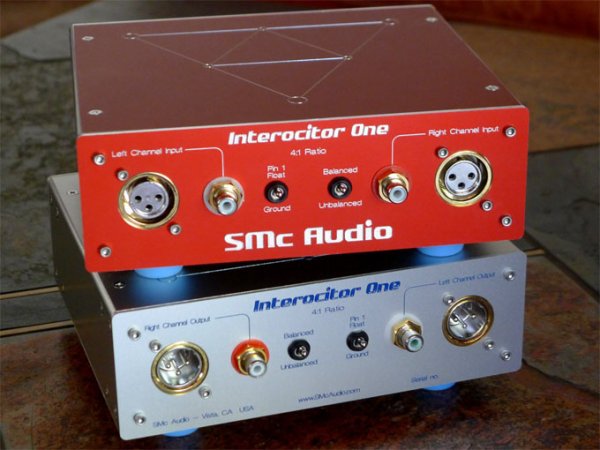

The Interocitor comes with both inputs and both outputs.

Yes, I sell it with a 2-week, money-back guarantee - you just cover the shipping if you decide to return it. I am in the process of finishing the production design change to the "Flex-Connect" name, along with a slight change to the chassis. The new model will be available shortly, in about 2 or 3 weeks. I do plan to make it available through retailers nationwide as soon as possible, but that is a process that takes some time. For the moment, it is available from me directly.
